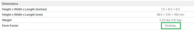

This is especially true for models such as the FortiGate-30E, 40F, 60E, and 60F (i.e., units with less than or equal to 2GB of RAM). Refer to the Form Factor field in the product datasheet to identify the hardware type/form factor.
