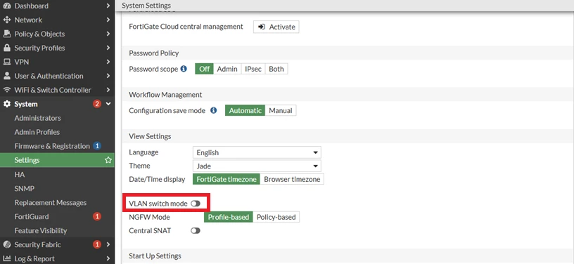

To enable the hardware switch interface option, disable 'virtual-switch-vlan' from global settings.
config system global
  set virtual-switch-vlan disable
To disable virtual-switch-vlan from the GUI, go to System -> Settings and disable VLAN switch mode:
