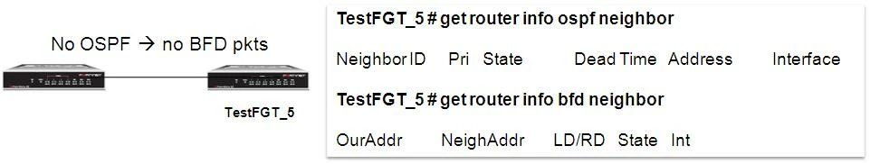

If BFD is configured but not OSPF, no BFD packets are sent.

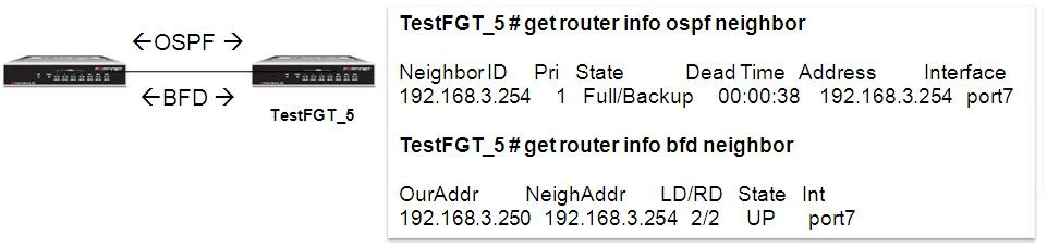

When OSPF is operational, it is possible to see BFD neighbors together with OSPF neighbors.

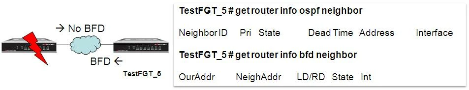

BFD failure due to remote router (neighbor) failure.
Starting from the previous state (BFD neighbor is up), the BFD failure detection in this case is immediately followed by a withdrawal of the failed OSPF neighbor, triggering route reconvergence.

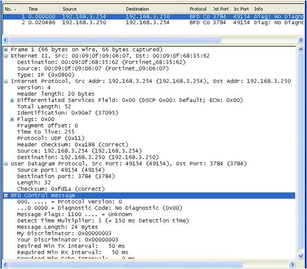

BFD packets are seen with a packet decoder:
