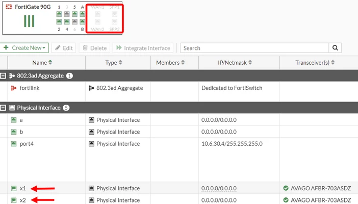

This article describes a cosmetic bug that has been observed on FortiGate 90/91G Gen2 series, where the GUI faceplate does not show the status for port x1 and x2 after the changes mentioned in the article below:
HA unsupported between different FortiGate 90G and 91G series hardware generations.
Scope FortiGate 90G, FortiGate 91G (Generation 2).
On the GUI, the faceplate will show as wan1 and wan2, despite FortiGate 90/91G being equipped with x1 and x2 ports. The ports will be greyed out while the interface list will show that ports x1 and x2 are connected:
This has been confirmed as a cosmetic bug on the FortiGate 90G and FortiGate 91G Generation 2, and there is no impact on traffic processing.
Workaround:
  1. Check the interface status from the GUI as per the arrow pointed in the image above.
  2. Check for the interface status and statistics from the command line:
diagnose hardware deviceinfo nic x1
diagnose hardware deviceinfo nic x2
get system interface
