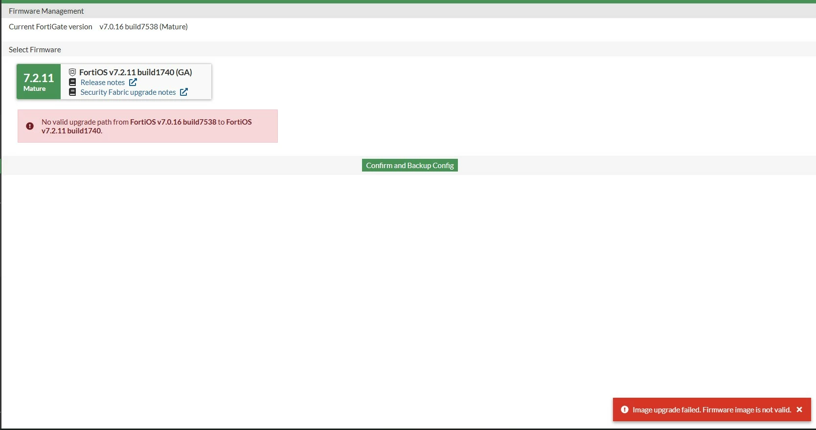

This article describes an error when upgrading a FortiGate 90G/91G/120G/121G high availability cluster from FortiOS v7.0.12 to 7.0.14, v7.0.16 to v7.0.17 or higher branches such as v7.2.x, v7.4.x, or v7.6.x.
GUI error: 'Image upgrade failed. The firmware image is not valid':
CLI error:
This operation will replace the current firmware version!
Do you want to continue? (y/n)y
Verifying the signature of the firmware image.
Warning: Upgrading to an image with Mature maturity notation.
Checking new firmware integrity ... pass
Please wait for system to restart.
Wait for HA to be primary of all clusters....
Send image to HA secondary.
image checking on HA secondary fails, abort upgrade
FortiGate-90G and 91G, FortiGate-120G and 121G.
