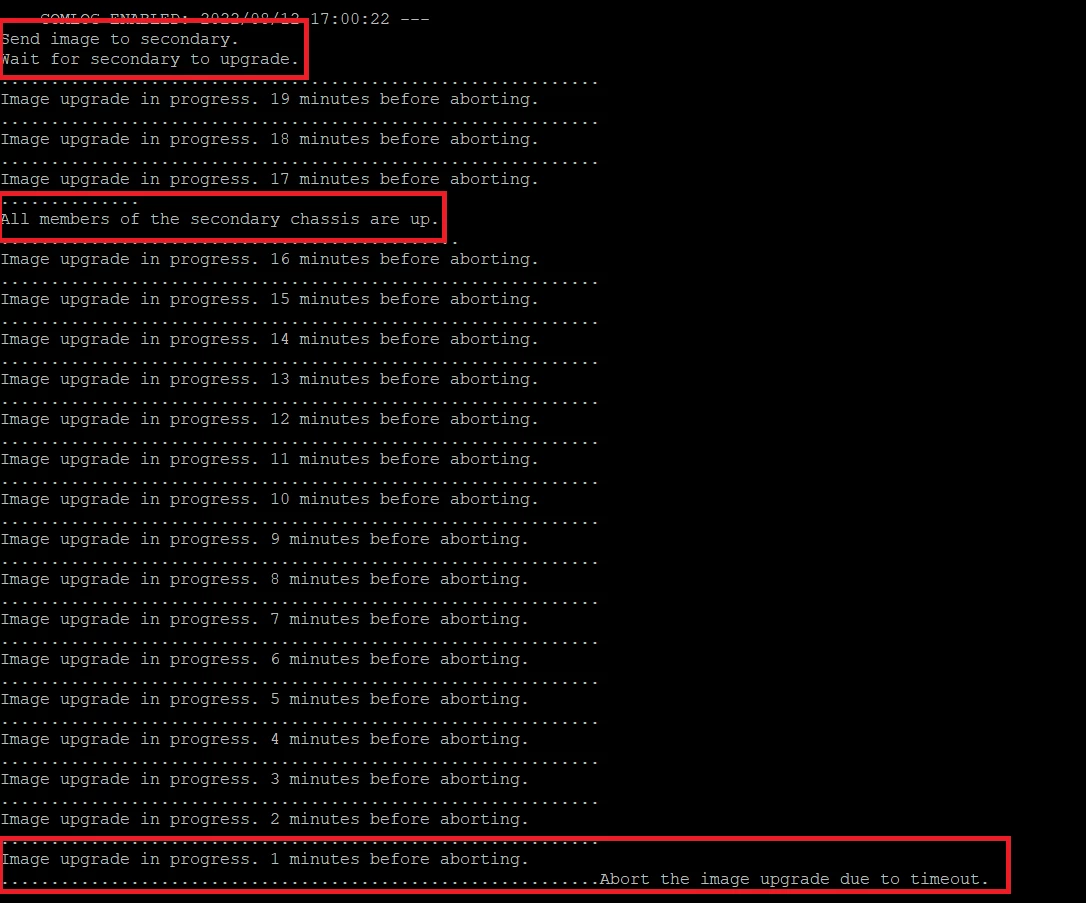

The upgrade process is initiated from the master. Slave upgrades itself. Master reports slave is back online but the failover never takes place.
Master counts down until the upgrade times out, slave reverts its firmware to the initial version and the upgrade process is finished.
(Both members are in starting FortiOS version and no failover happens. Meaning no service disruption but the upgrade is not completed either).

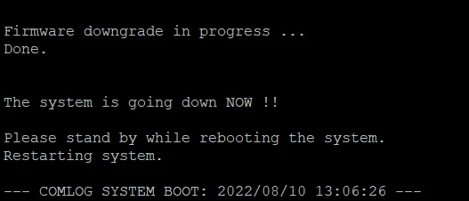

Comlog of slave will report one successful upgrade and 20 minutes after the message of rollback:
(In case there is console connectivity, the same messages could be tracked through console as well).

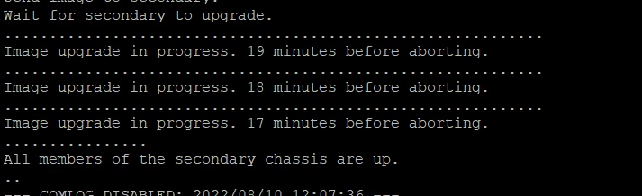

4) Constantly check the Comlog (or console )of MASTER. It will keep reporting the message 'Image upgrade in progress. 19 minutes before aborting'
Seeing 'All members of the secondary chassis are up' message on Master FortiGate Blade is a prerequisite to proceed.

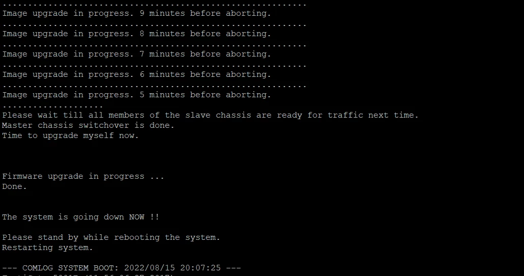

6) On Master FortiGate Comlog , once the 'Image upgrade in progress. 7 minutes before aborting' is seen (7 is not an exact number, just give the chassis 10-12 minutes.) from controller, force a failover.

8) Once the failover is triggered, the Comlog of the INITIAL (now former) master will report the following:
9) There is nothing special to be done after this step. Verify that the initial master is also upgraded to the same firmware.
