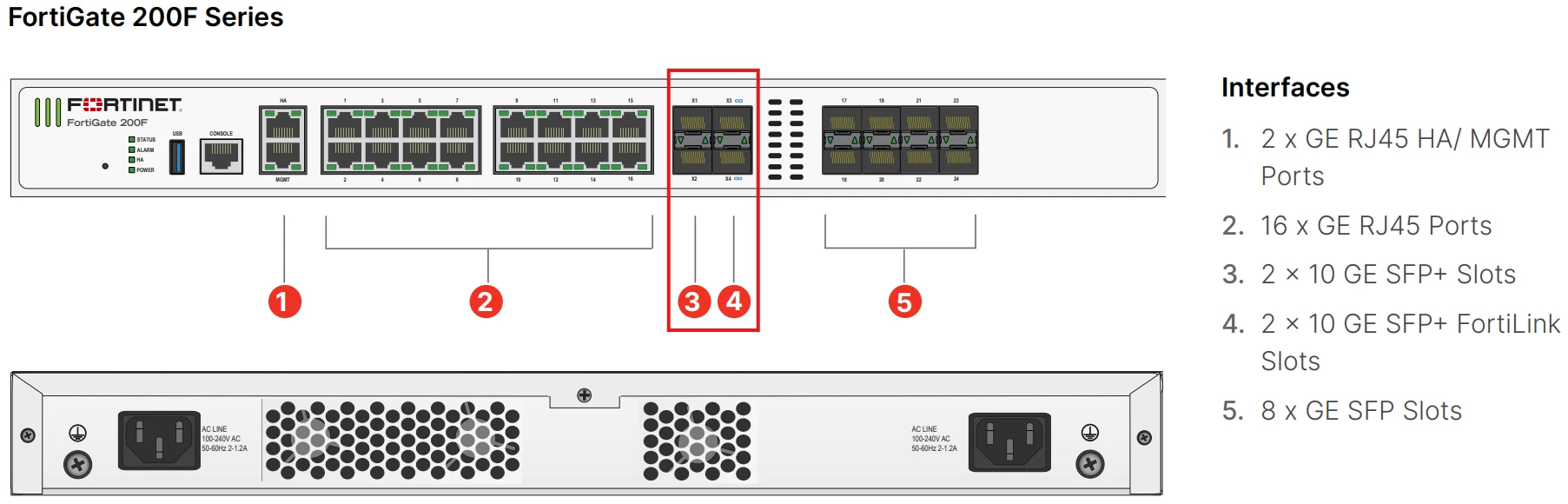

One contributing factor to this issue is that the FortiGate-200F/201F does not have hardware support for the SFP/SFP+ 'TX_Disable' pin, which is traditionally used to disable the transmit laser on an SFP transceiver.
