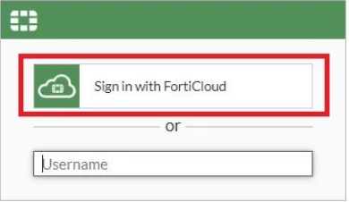

This issue can occur after FortiCloud SSO has been enabled on a FortiGate High-Availability (HA) cluster that appears in sync. After an HA failover, when performing FortiCloud SSO authentication, the BIOS certificate on the secondary FortiGate is used to generate the SSO request, while the SSO daemon continues running on the primary FortiGate.
When the primary FortiGate validates the serial number contained in the SSO IdP response, it detects a mismatch between the serial number associated with the SSO request and its own serial number. As a result, the primary FortiGate rejects the SSO authentication request, causing the user login to fail.
