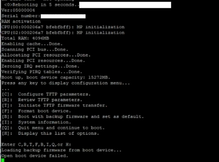

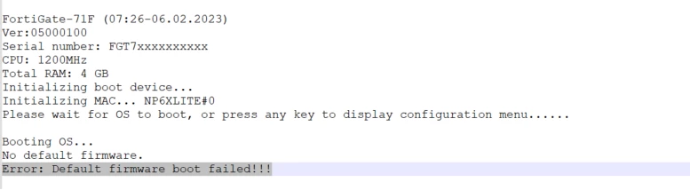

It is also necessary to install firmware using the local TFTP server if the 'OPEN BOOT DEVICE FAILED' message appears on the console as follows:
Some devices would report this as 'Default firmware boot failed!' in the console when the system boots up.

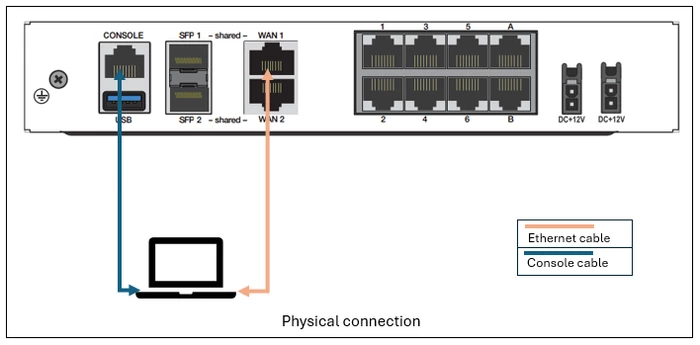

Physical connection:

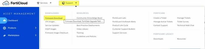

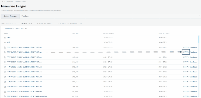

Download the required images from the support portal page at Support -> Support -> Firmware Download. Select and download the specific firmware version needed, as shown in the screenshot below.

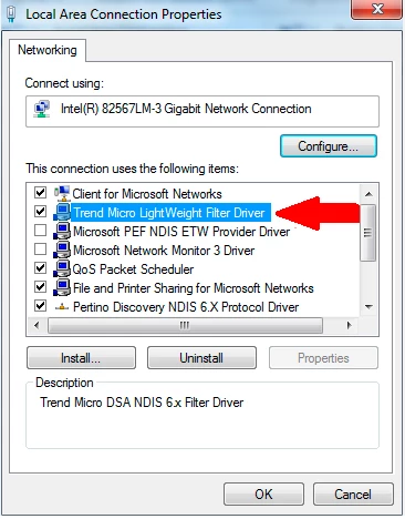

Disable the Windows firewall or any other third-party packet filtering application (for example, Trend Micro Lightweight Filter Driver).
Why Windows Firewall (Private and Public Profiles) needs to be temporarily disabled during firmware upgrades:

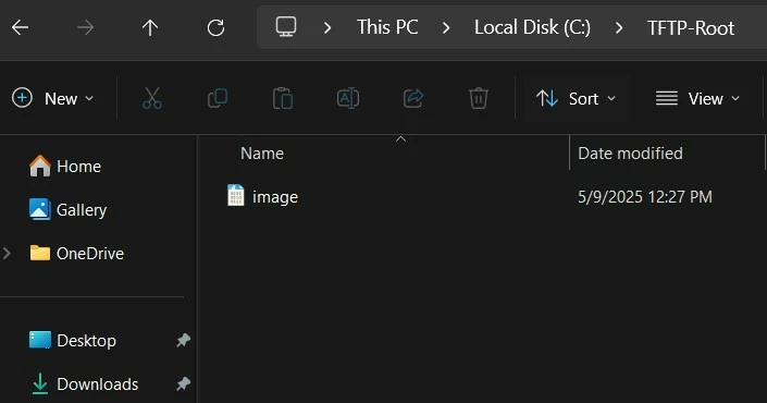

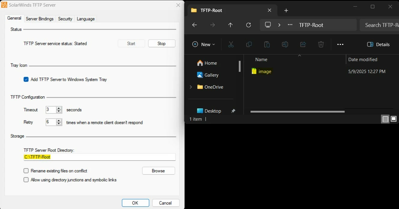

Create a directory and name it something like 'TFTP'. Move the firewall image to that directory. Rename the firmware image file to 'image' while keeping the original file extension as '.out'. The reason for renaming the image to 'image.out' is to have a much shorter file name compared with the default file name when the file is downloaded from 'support.fortinet.com'. If the file name is not changed, it can cause the TFTP file transfer to fail with the following error:

Ensure that only the firmware file named 'image' is present in the TFTP server's 'Current Directory.' If other files are in the directory, FortiGate may fail to load the firmware, even if the file name matches 'image.out'.
Note 2:
After formatting the FortiGate, it is normal for the SolarWinds TFTP Server not to display the IP address 10.10.10.1 in the binding list, as shown in the above image. This can be disregarded to proceed with the subsequent steps.

Connect the computer to the FortiGate unit using the null modem cable. For detailed steps for this connection, see this article: Technical Tip: How to connect to the FortiGate console port.

Restart the FortiGate. When the console displays 'Press any key to display configuration menu...', press any other key. If the configuration menu does not show, that means Restricted mode is enabled. Press Ctrl+B upon booting up the device to enter the Configuration menu.

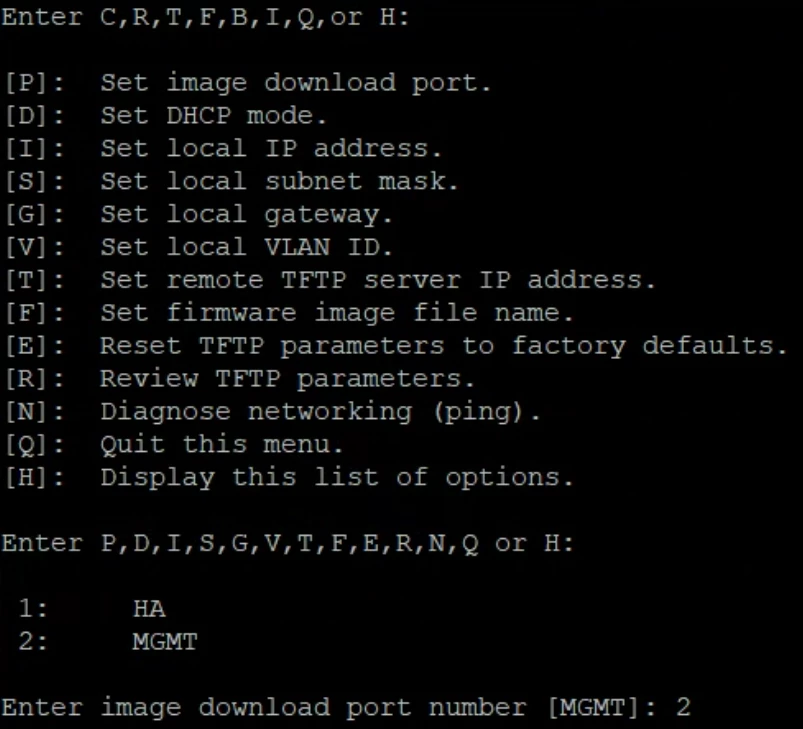

Change the parameters to be in line with the TFTP server configuration.
[P]: Set firmware download port.
[D]: Set DHCP mode.
[I]: Set local IP address.
[S]: Set local subnet mask.
[G]: Set local gateway.
[V]: Set local VLAN ID.
[T]: Set remote TFTP server IP address.
[F]: Set firmware file name.
[E]: Reset TFTP parameters to factory defaults.
[R]: Review TFTP parameters.
[N]: Diagnose networking(ping).
[Q]: Quit this menu.
[H]: Display this list of options.
Enter P,D,I,S,G,V,T,F,E,R,N,Q,or H:    <----- [I]: Set local IP address.

The link light on the FortiGate port used for firmware download and connect machine port will not blink or show up until the TFTP firmware transfer is initiated, as shown in the next step.
The firmware image download Port can be changed from the Option 'P'.

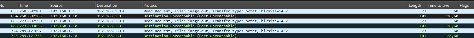

At times, the file transfer might not yield any errors or indicate that a connection to the TFTP server is being initiated, and it may appear to be stalled, as illustrated below:
Please connect TFTP server to Ethernet port 'WAN1'.
MAC: 94:ff:3c:6e:e9:66
Gathering a Wireshark capture on the interface linked to the TFTP server would reveal that the destination port is unreachable, as demonstrated in the capture below:

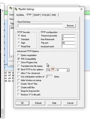

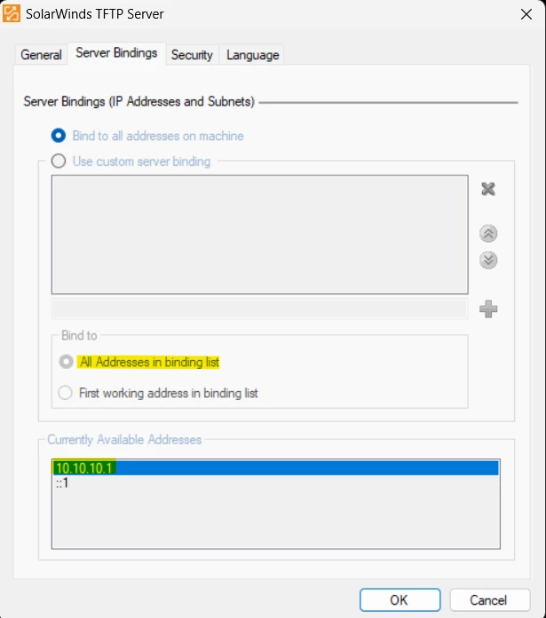

Review the TFTP server settings and make sure that the security level is set to none and the advanced TFTP options are set as follows:
After making these changes, the transfer of the file will start successfully.

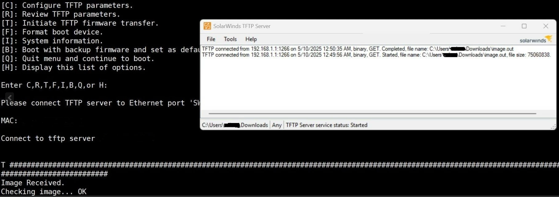

After this is connected and the transfer has begun, the screen will start filling with the '#' symbol, as shown below. This means that the TFTP transfer has started successfully.
Image Received.
Checking image... OK
This firmware image is certified!

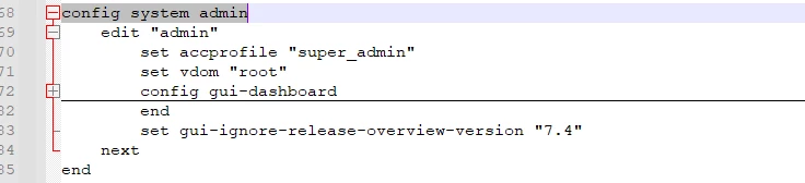

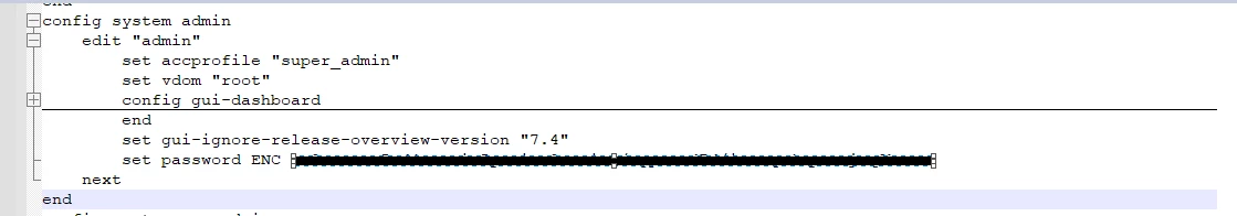

If formatting needs to be completed due to a lost admin password and an existing backup configuration has to be re-imported, make sure that the password configuration line has been removed from it, as shown in the screenshots below:
Edit the backup config text file with a text editor such as Notepad++, delete the 'set password' line from the configuration, and save the file as a new file with a .conf extension.

  • Consider when the PC is running Hyper-V. Windows automatically enables a virtual switch filter driver on the NICs. This will interfere with network traffic like TFTP (UDP/69) or broadcast traffic. That might be the reason why the FortiGate device cannot pull the file even though the TFTP server is running.
