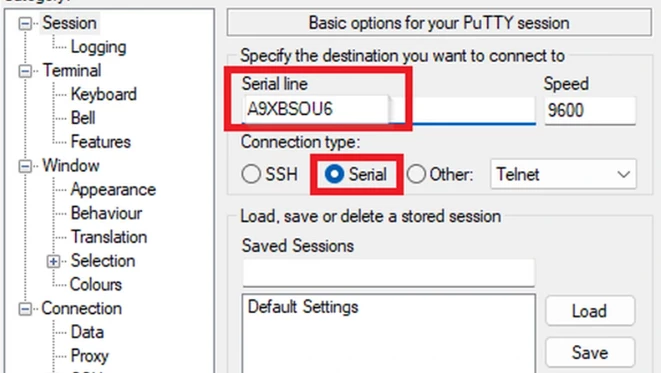

  1. Connect to the FortiGate console port using PuTTY on macOS:
Connect the Serial to the USB adapter to the PC.
Open a terminal and list available serial ports:
ls /dev/*usb*
Find a device like /dev/tty.usbserial- (e.g., /dev/tty.usbserial-A9XBSOU6). Note this name: it is the serial port for PuTTY.
Open PuTTY and use the following settings:
