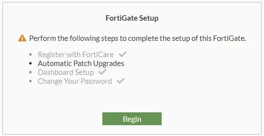

To view the firmware upgrade notifications in the GUI.
Log in to FortiGate.
The FortiGate Setup window includes an Upgrade firmware step.
Select 'Begin'.

For versions 7.2 and newer, the banner has changed:
This warning will be displayed even if the Automatic Patch Upgrades are manually disabled (not desired).
The last 2 elements need to be acted upon (set up the dashboard and change the default password).
However, to dismiss the banner, use this command:
config system global
    set gui-auto-upgrade-setup-warning disable
