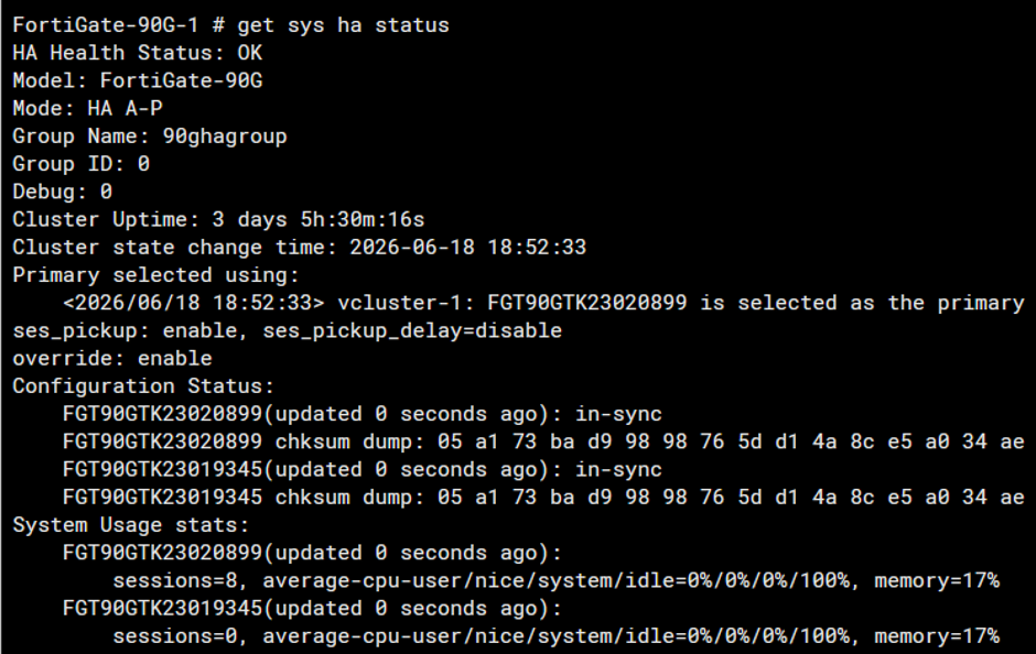

  1. HA is initially in-sync:

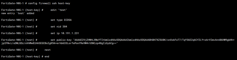

  2. Configure ‘firewall ssh host-key’. This is an example host-key that can be configured to test this.
config firewall ssh host-key
    edit "test"
        set type ECDSA
        set nid 384
        set ip 10.191.1.231
        set public-key "AAAAE2VjZHNhLXNoYTItbmlzdHAzODQAAAAIbmlzdHAzODQAAABhBH7XZSU8K/xnXxkFoT7/TqY56E2q6CfZLY+zArVImvAnnB6HW9gbHh+jpIFNvi/uDNLGDz/oVAMw8lHA5EGCBsIgK9A+erhb633LorfePonfRe9W4rUSNlzp48gIiGybCg=="

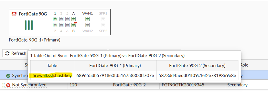

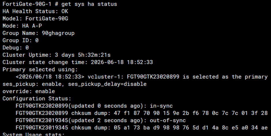

  1. After configuring the SSH host-key (the same behavior is seen on local-key), the HA goes out-of-sync:
  1. On the FortiGate GUI, System -> HA, the HA is out-of-sync. After hovering the mouse over the ‘Not Synchronized’ text, the respective object that caused the HA to go out-of-sync can be seen:

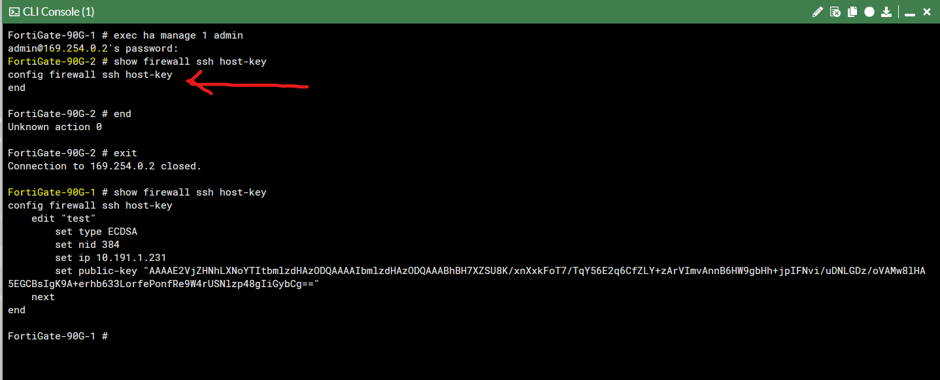

  1. Verifying this in the CLI, the ‘firewall ssh host-key’ configuration on the secondary firewall is not present and did not sync over HA:
This is a known issue that happens on FortiGate G series firewalls running the version 7.4 firmware. This issue is not seen on FortiGate G series running FortiOS firmware version 7.6.6.
