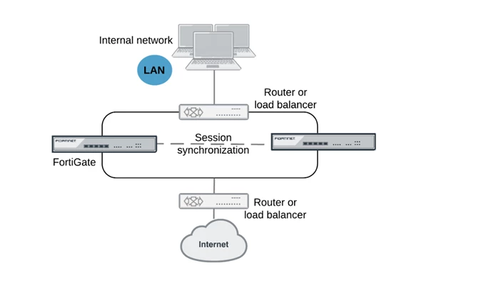

This article describes how to configure FGSP session synchronization between standalone chassis FortiGates.

Standalone session synchronization is deployed for session-synchronization among multiple data centers
Example of standalone session synchronization between two data centers.
Use the following command to configure an FGSP HA cluster-sync instance:
#config system cluster-sync
set peervd "mgmt-vdom"
set peerip 10.10.10.1
set syncvd "VDOM-1" "VDOM-2" "VDOM-3"
HA configuration session:
#config system ha
set session-pickup enable
set session-pickup-connectionless enable
set session-pickup-expectation enable
set session-pickup-nat enable
set override disable
Important Note: To have confidence that configuration on both Chassis is matching, please perform primary node configuration backup, adjust it to secondary node requirements (hostname, end-to-end IP address(between chassis), system cluster-sync addresses) and recover pre-prepared configuration file on secondary node.
Verification:
Check and compare sessions existence on both nodes
#diag sys session list
