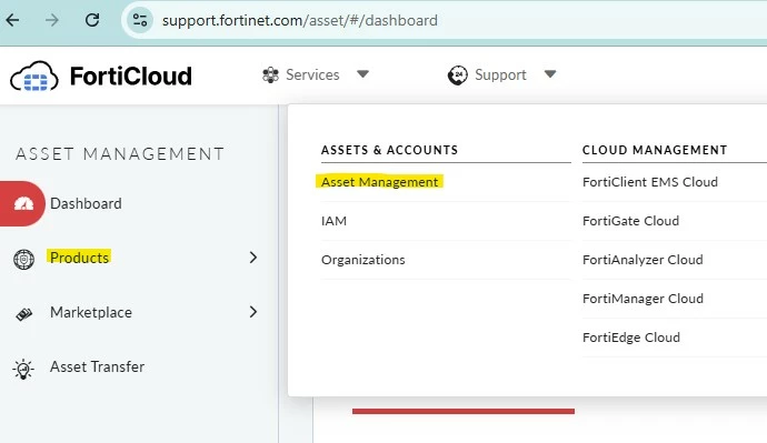

  1. Visit the Fortinet Support website at Support.
  2. Select Services -> Asset Management:
  • Go to Product -> Product List.
  • Select the serial number of the FortiGate.
  • Under the License & Key section, select Download to get the License File. The file downloaded to the device is in the format FG*********.lic.

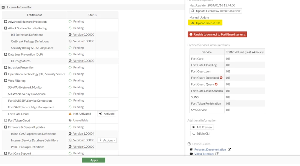

  1. In FortiOS, go to System -> FortiGuard.
  2. Select the 'Upload License File' and upload the license file.
This operation does not require a reboot. Once the upload is completed, the FortiGate shows as registered and licensed. The device is now ready to proceed with the firmware upgrade.
