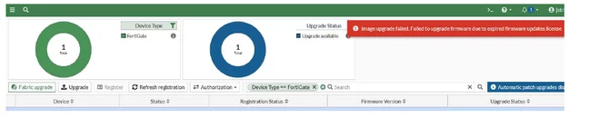

While upgrading the FortiGate 30G/31G units via FortiGuard or the manual method, the upgrade fails with the error 'Image upgrade failed. Failed to upgrade due to expired firmware updates license', even though the license is valid.
