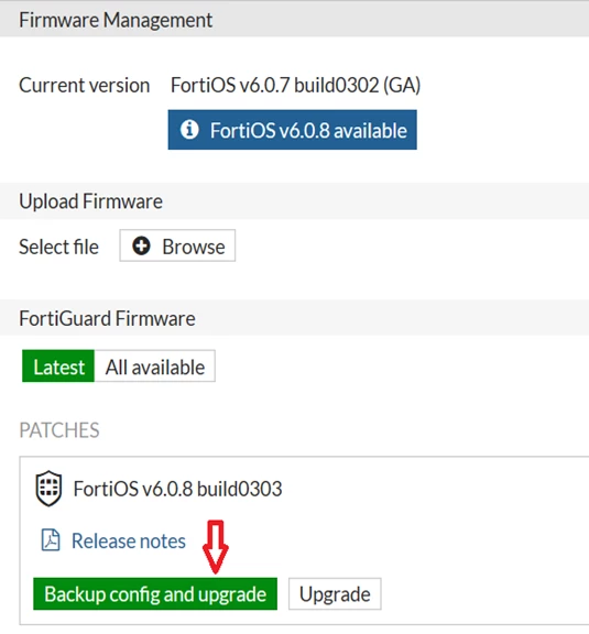

To upgrade the firmware, go to System -> Firmware.
The firmware management shows the current version running on the unit and the next available version.
Before performing the upgrade, verify the upgrade path (if applicable) and refer the release notes of the firmware which the unit suggests to upgrade.
Example:
If the Current version shows as FortiOS v6.0.7 build0302 (GA)
It will show the firmware version which can be upgraded on the unit, as shown below:
The above is just an example; as per the unit firmware and the available firmware versions to upgrade, it shows the information.
Select 'Backup config and upgrade', a new window will open as shown below:
Select 'Continue' to upgrade the firmware, it takes some seconds, and if the upgrade fails, the following error appears:

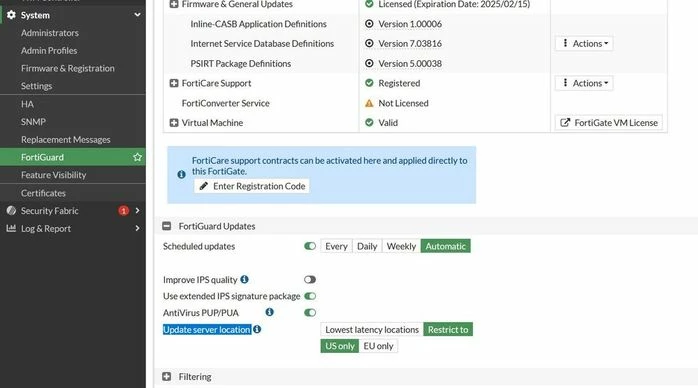

In some cases, changing the FortiGuard Server's location will resolve this issue.
Navigate to System -> FortiGuard -> FortiGuard updates -> Update server location -> Restrict to -> US only.
Test it by changing to the EU as well.
