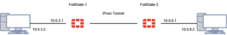

For an example configuration where the ‘set initiator-ts-narrow enable’ setting would be useful, consider the following topology and phase2 selector configuration on two different FortiGates:
Topology:

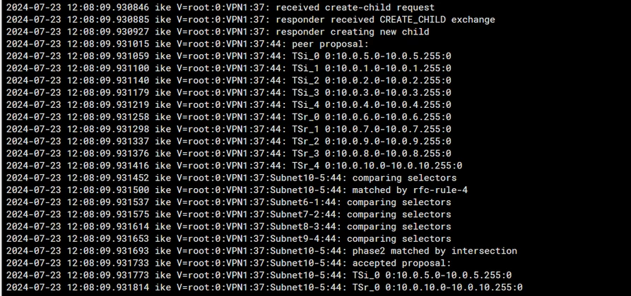

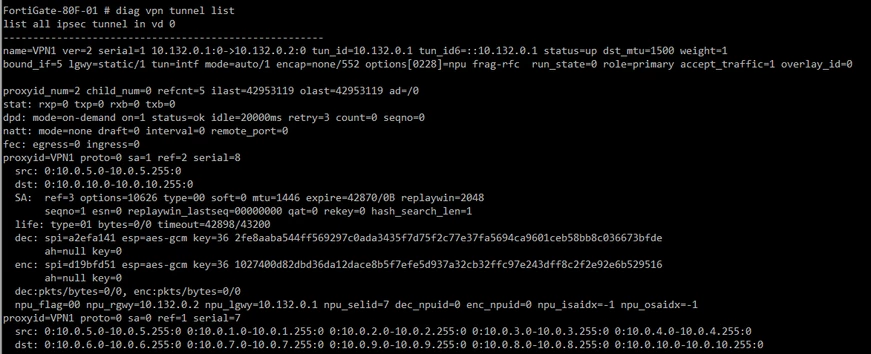

By default, with the ‘initiator-ts-narrow’ option disabled, bringing up the IPsec phase2 selector on FortiGate-1 will result in only one selector negotiating:
This is despite FortiGate-2 receiving the full list of selectors from FortiGate-1, as visible in IKE debugs:

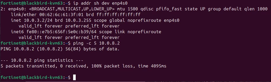

Additionally, pings from a client at 10.0.3.2 to 10.0.8.2 fail, with IKE negotiation only bringing up the selector between 10.0.10.0/24 and 10.0.5.0/24.

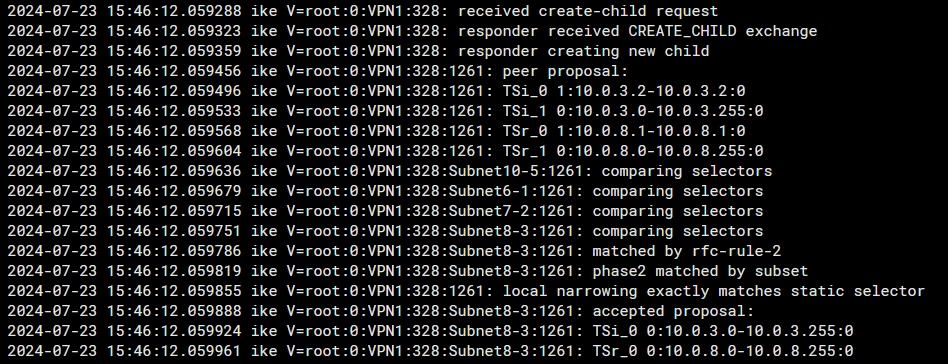

With the ‘initiator-ts-narrow’ setting enabled, FortiGate-1 will now send the following subnets in the phase2 negotiation when traffic triggers an IPsec tunnel to come online:
  1. The exact pair of IP addresses on the packet triggering the packet. In this topology, that would be 10.0.3.2 pinging 10.0.8.2.
  2. The first configured pair of subnets in address groups encompasses the IPs triggering the Phase2 configuration. In this example, that would be 10.0.3.0/24 and 10.0.8.0/24.
The reduced number of selectors is visible in the IKE negotiation on FortiGate-2:

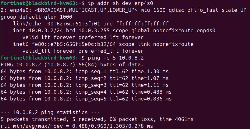

With FortiGate-2 correctly selecting 10.0.3.0/24 & 10.0.8.0/24 as the selectors in use, pings now work successfully:
