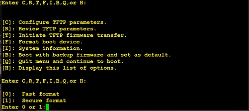

The FortiGate 7xG series model has two options for flash formatting, as shown below:
The differences between these options seen on the BIOS are as follows:
  • Fast format: This option only erases initial blocks of partitions.
  • Secure format: This option performs whole disk overwrite following 'nist800-88' guidance.
