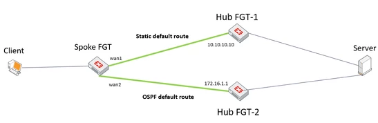

The following diagram illustrates a typical topology in which a client behind Spoke FortiGate can reach a server via two possible links:
The options are as follows:
A) Routing through a default static route towards FGT-1.
B) Routing through the OSPF default route advertised through FGT-2.
The FortiGate administrator's goal in this case would be to load balance the traffic towards both links at the same time thus he/she adjusted the Administrative Distance (AD) of the static route to 110 so it can be equal with the OSPF one:

Issuing the command get router info routing-table all on the Spoke FortiGate will produce an output similar to the following:
Routing table for VRF=0
S *> 0.0.0.0/0 [110/0] via 10.10.10.10, wan1
O E2 0.0.0.0/0 [110/1] via 172.16.1.1, wan2
Note: Only one protocol's route to the same destination will be processed by the kernel at the same time. As a result, FortiOS will choose to route packets through the static default route, and will only use the OSPF default route when the wan1 link becomes inactive.
