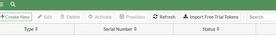

  1. If it is a Trial Token.
Delete the Trial Token -> Re-import Free Trial Token under User & Authentication -> FortiTokens, and it will work fine.
To delete the trial FortiToken in the CLI:
config user fortitoken
    delete <fortitoken_serial_number>
To import trial tokens in the CLI:
execute fortitoken-mobile import 0000-0000-0000-0000-0000

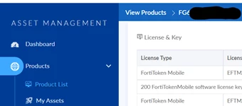

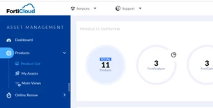

  1. Log in to Support.
  1. Select products and then select the correct serial number for the FortiGate.
  2. Check under the License and Key section, where FortiToken License information will be available. If it is not available, it is not registered with this unit. Check the other units.
  • Once the registered unit is confirmed with FortiToken, make sure the FortiGate is in the Primary state in the HA environment. Only after that is it possible to provision FortiTokens.
  • It is not possible to provision a FortiToken from an unregistered FortiGate.
