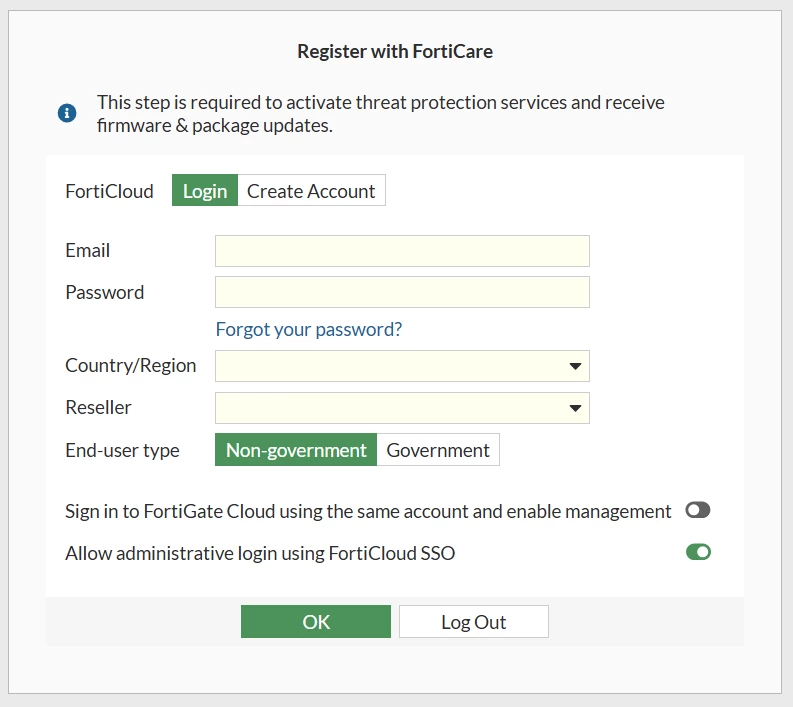

In FortiGate G-series hardware platforms such as FortiGate-30G and FortiGate-201G, the FortiGate shows a prompt on initial login, saying: 'Register with FortiCare. This step is required to activate threat protection services and receive firmware & package updates.'
Enforcement Introduction:
  • In v7.4.8, only FortiGate-20XG and 90XG models had the prompt, and it was possible to configure the devices using CLI before registration.
  • In v7.4.9 and later, most G series models have the FortiCare registration check, and some CLI configuration is restricted.

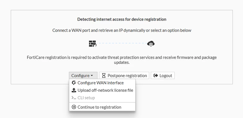

The 'Register with FortiCare' prompt will be displayed when logging in to the device via the GUI. On earlier firmware versions, there is no option to skip it.
Enhancements:
The FortiCare registration check logic is optimized starting in FortiOS v7.4.10 and v7.6.5, allowing IP address configuration using the GUI before registration, a seven-day setup period after first power on, as well as a manual license upload option for air-gap deployments.
For more details on the use of an off-network license file, including where to download the file, see the FortiOS Administration Guide: Registering recent FortiGate models in an air-gapped environment.

  • Starting with FortiOS v7.4.10, newer FortiGate hardware models provide a seven-day grace period for initial configuration before mandatory FortiCare registration enforcement. The grace period is triggered upon the first power-on event of the FortiGate device. The countdown timer is suspended when logging out of the FortiOS management interface, and the device is powered off. For more information, see Seven-day setup period for GUI and CLI configuration.

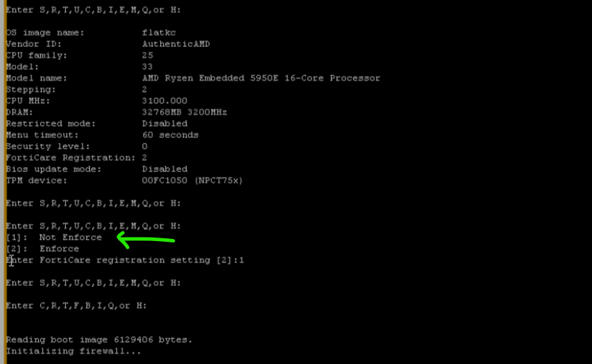

  • By default, FortiGate devices with newer BIOS versions are configured with FortiCare registration level 2, requiring registration before GUI access. This setting can be changed to level 1 via the BIOS menu to bypass FortiCare registration.
To change the FortiCare registration level, refer to the document: Enforce FortiCare registration after new GUI login 7.2.11.

    This might be the dumbest most annoying change Fortinet has made to date! Being stuck at the registration prompt prior to initial configuration?! How dumb is this? You can’t register because well, the Fortigate is unconfigured and doesn’t have Internet access! The only two options are OK or LOG OUT. I can’t click ok because I can’t set the country and reseller. My only option is to click LOG OUT! So now I have to somehow configure via CLI? Also, before I replace the unit currently in place I need to setup side by side to make sure my config is good. This is just another time waster! Thanks Fortinet
