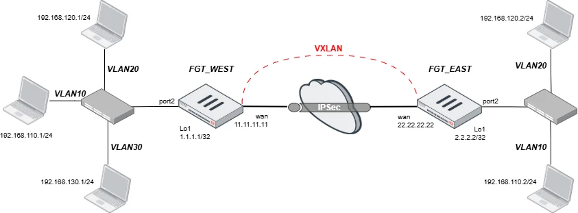

The following infrastructure diagram consists of 3 VLANs (10, 20 and 30) in the WEST side and 2x VLANs (10 and 20) in the EAST side.
The objective is to enable Layer 2 traffic between both sites using a single VNI.
For this purpose, the VLAN tag will be encapsulated inside the VXLAN.
This scenario is applicable when Layer 2 traffic from multiple customer VLANs must be supported, with a dedicated VNI for each customer.
Note: connection between switches and FortiGate are in trunk mode.

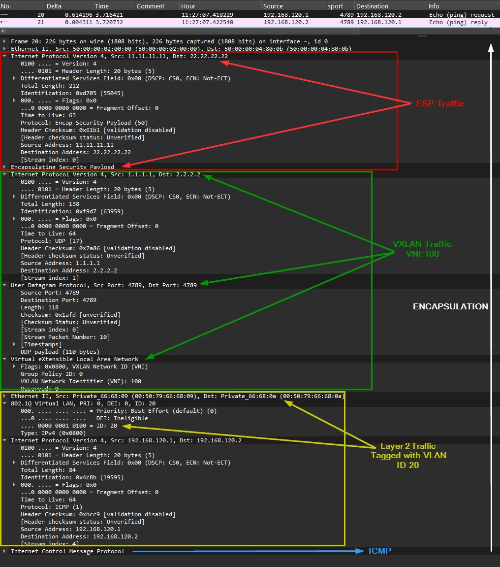

The following is a packet capture taken on-wire, after the frame egressed from the FGT_WEST WAN interface.
ESP traffic was decrypted, and this is the result of a ping from 192.168.120.1 to 192.168.120.2:
ICMP (echo request) will be tagged using VLAN ID 10 and encapsulated by the VXLAN with VNI 100.
This traffic is then encapsulated by ESP and flows to the remote site which is decapsulated in the reverse order.

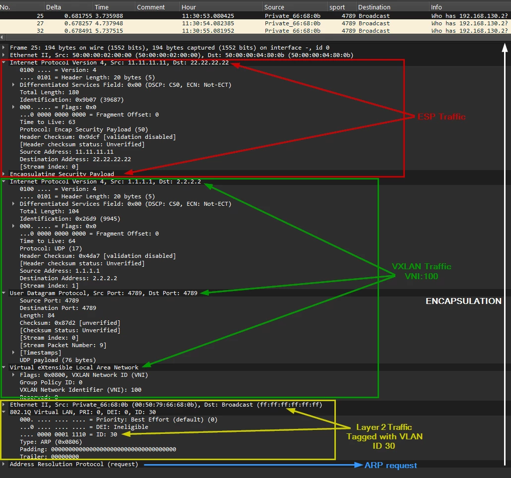

Here is a pcap taken on-wire, after frame egressed from FGT_WEST wan interface.
ESP traffic was decrypted and this is the result of a ARP request from 192.168.130.1 to 192.168.130.2 (non existing machine):
ARP request from VLAN 30 will reach FortiGate port2 and this traffic will be encapsulated by the VXLAN with VNI 100.
However, the remote site does not have VLAN 30, so VXLAN traffic is flowing for non-existing VLANs in the remote side.
Trunk on the switches should be adjusted to permit only the necessary VLANs to prevent unnecessary VXLAN traffic when this method is used.
