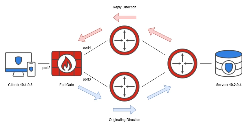

FortiGates configured for ECMP and/or SD-WAN can have multiple paths to reach a given remote network destination, and when the FortiGate receives traffic from a client, it will perform a route lookup and select one of the ECMP routes as the outgoing path. However, in some cases, reply traffic can arrive back on the FortiGate using a different ECMP interface than was used in the originating direction. This is referred to as asymmetric traffic flow.
In FortiOS v6.2.3 specifically, the FortiGate kernel handled this flow differently from other versions before or since. Consider the following debug flow output for a TCP session between a client and a server, which is based on the topology diagram shown above:
  1. Client 10.1.0.3 sends TCP SYN to Server 10.2.0.4. Packet arrives on FortiGate port2 and is routed out via port3:

  1. Server 10.2.0.4 receives the packet and sends a SYN/ACK in response. The packet is routed back towards the FortiGate's port4 interface, rather than port3. The FortiGate matches the packet to the existing session, then updates the session to allow reply traffic from port4 towards port2:

  1. Client 10.1.0.3 sends a TCP ACK to complete the TCP three-way handshake. However, the FortiGate drops the packet because the previous SYN/ACK caused the outgoing interface for the session to be changed/relearned. When the client attempts to retransmit the ACK, the packet is dropped since the session entry no longer exists:

In FortiOS v6.2.3, this issue can be addressed by enabling the auxiliary-session feature (configured on a per-VDOM basis). This allows the FortiGate to create secondary sessions (aka auxiliary or reflect sessions) that can allow this asymmetric traffic to flow successfully:
config system settings
set auxiliary-session [ enable | disable ]
Note that in FortiOS v6.2.4 and later, this behavior has changed such that traffic will flow successfully even when auxiliary-session is disabled. Instead of dropping traffic, the FortiGate will instead continuously dirty the session whenever the outgoing interface changes. This allows traffic to flow, but it has the downside of preventing hardware-offloading from being activated for that particular session. Enabling auxiliary-session will correct this and allow the FortiGate to offload this asymmetric traffic flow successfully.
