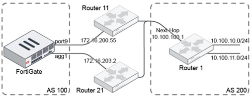

In this example, there are two static routes.
The FortiGate has learned two BGP routes from Router 1 that have the same next hop at 10.100.100.1.
The next hop is resolved by the two static routes.

Note that for FortiOS v6.4 and earlier, When there are multiple ECMP routes to a BGP next hop which require recursive resolution, then BGP selects only the first ECMP route for the resolution.
So in the above example, the subnet 10.100.100.0/24 could be reached via both port9 and agg1, because BGP next-hop 10.100.100.1 is reachable via both of them. However, BGP installs route 10.100.10.0/24 only against port9 as BGP selects only the first ECMP route for the resolution.
This not only means that the outgoing traffic won't be load-balanced, but it also means that the traffic that arrives on agg1 will be potentially dropped by RPF check.
In FortiOS v7.0.0 and later, all ECMP routes are considered for the next hop recursive resolution.
