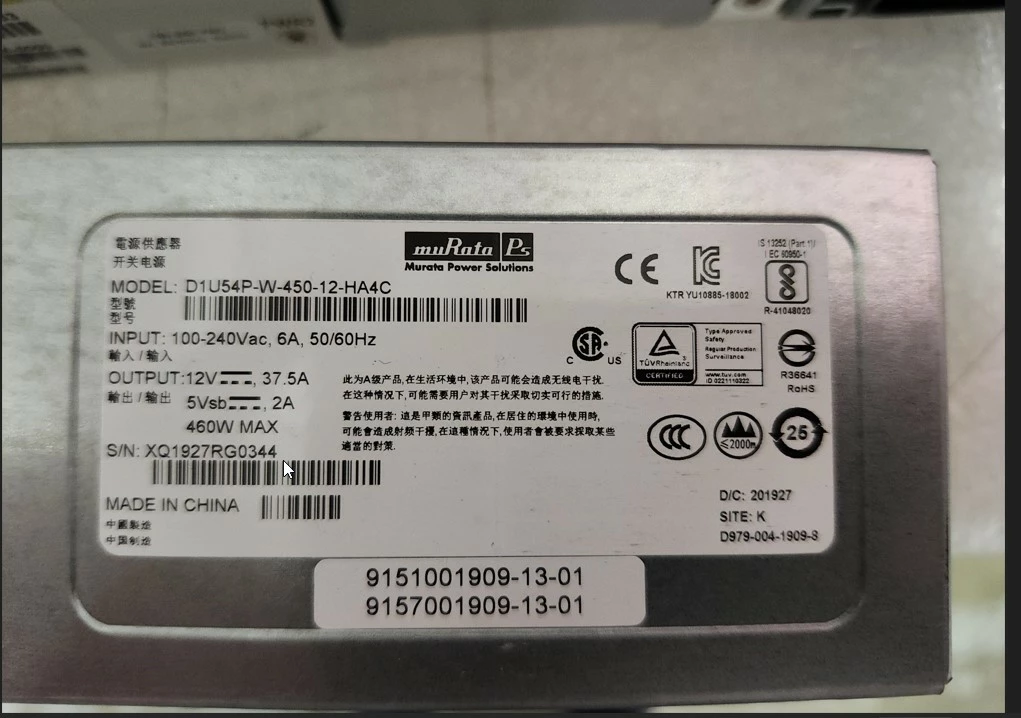

This article describes how the FortiGate 300E and FortiGate 500E series are supplied with a single power supply and have a slot available for an additional power supply.
FortiGate.
Additional power supplies can be ordered (SP-FG300E-PS) and inserted the item into the slot.
The power supplies are hot-swappable.
Murata provides these power supplies and corresponds exactly to the model Murata D1U54P-W-450-12-HB4C.
