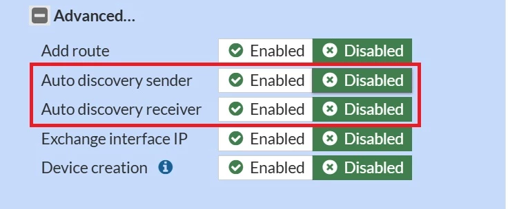

During a maintenance window, on HUB, perform this change:
  edit <vpn-name>
    set auto-discovery-sender disable
On Spoke:
  edit <vpn-name>
    set auto-discovery-receiver disable
After disabling shortcuts (auto-discovery), reply traffic from the hub to spokes will no longer match any dynamic shortcut SA. For correct traffic forwarding, Enable net-device on the hub:
  edit <vpn-name>
    set net-device enable
This ensures that the hub maintains correct kernel routing for traffic destined to spokes, even when shortcuts are disabled.
