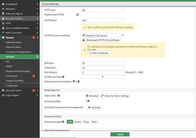

Log in to the device with the super-admin privilege admin account and go to settings.
Search 'Allow concurrent sessions' and disable the option (by default, it is enabled).
Apply the settings.

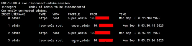

Note: When an admin session is active through one protocol (such as SSH), no other admin sessions (like HTTPS) can be established until the current session ends. However, 'jsconsole' (GUI CLI Console) sessions, listed under 'exec disconnect-admin-session', are exempt from this restriction and do not count toward the one-session limit.
