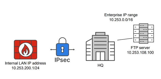

This article describes how to configure FortiGate to send locally-generated TFTP backup traffic using a specific source IP. This is especially useful in scenarios where the TFTP server is reachable using an IPsec VPN interface.
FortiGate v7.4.
Topology:
config router static
    edit <index>
        set dst 10.253.108.100 255.255.255.255
        set device "FGT-Spoke"
While 10.253.108.100 is reachable through an IPsec tunnel 'FGT-Spoke', locally-originated traffic to this destination currently fails since it is being sent with an unintended IP address. The HQ side is configured to only allow TFTP traffic sourced from the Spoke's LAN interface IP address 10.253.200.1.
