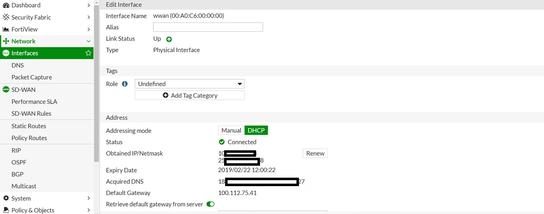

Shortly after LTE modem joins carriers's network, wwan will be enabled and granted direct IP:
FortiGate-600D # config system interface
FortiGate-600D (interface) # edit wwan
FortiGate-600D (wwan) # get
ip : 100.112.75.43 255.255.255.248
status : up
defaultgw : enable
DHCP Gateway : 100.112.75.41
Lease Expires : Thu Feb 21 19:33:27 2019
dns-server-override : enable
Acquired DNS1 : 184.151.118.254
Acquired DNS2 : 70.28.245.227

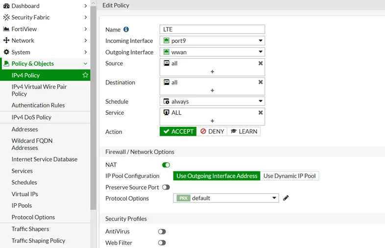

PC can reach internet via the following firewall policy:
config firewall policy
edit 5
set name "LTE"
set uuid 61880e9a-36ce-51e9-a4f4-15cc3ffc25f3
set srcintf "port9"
set dstintf "wwan"
set srcaddr "all"
set dstaddr "all"
set service "ALL"
set utm-status enable
set fsso disable
set nat enable
With LTE modem enabled, use the GUI to view the LTE interface and check the acquired IP, DNS, and gateway:It's possible to configure the firewall policy that utilizes this LTE interface:Limitations:- Most LTE modems have a preset APN in the SIM card.As a result, the APN doesn't need to be set in FortiOS configuration. In cases the Internet cannot be accessed, consult with the carrier about APN (for example, inet.bell.ca) and set the APN in LTE modem configuration.#config system lte-modem- Some FortiGate units have built-in LTE modems, such as the FortiGate-30E-3G4G. This type of FortiGate has LTE modem enabled by default.
