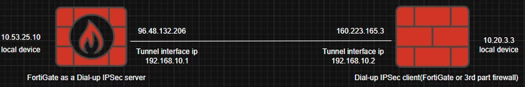

Consider the following example topology, where the FortiGate is acting as a dial-up IPsec server/hub and is using OSPF for dynamic route sharing to/from connected dial-up IPsec clients:
As a primer, FortiOS 7.0 and later introduced the concept of 'tunnel IDs' for dial-up IPsec tunnel interfaces. This tunnel ID is either set to the remote gateway IP address of the peer (e.g., the public IP of 160.223.165.3 for the example dial-up client given above) OR it is assigned a random tunnel ID in the 10.0.0.x range if there is already an existing device with the same public IP as the tunnel ID. For more info, see the following article: Technical Tip: Change in behavior of IPsec tunnel interface IP address and routing on FortiOS v7.x.
Trigger condition: When the dial-up Spoke has to re-establish the IPsec tunnel (such as when the dial-up client changes its public IP or if the tunnel flaps for some reason), then it is possible for a new, different tunnel ID to become associated with that Spoke on the FortiGate dial-up hub. However, while the IPsec tunnel connection uses the new tunnel ID, OSPF peerings will not automatically update to use the new tunnel ID since the inactivity timer has not yet expired.
When this occurs, traffic forwarding from the FortiGate hub to the dial-up Spoke stops functioning correctly, though traffic in the Spoke -> FortiGate direction does continue to work.
The reason that this traffic issue occurs is because the tunnel ID shown in the IKE gateway list (diagnose vpn ike gateway list) must match the tunnel ID of the OSPF interface and its associated routes in the routing table (get router info routing-table all). If they mismatch (such as one showing the Public IP of the Spoke and the other showing a dynamic 10.0.0.x ID value) then traffic will not be able to use those routes successfully.
