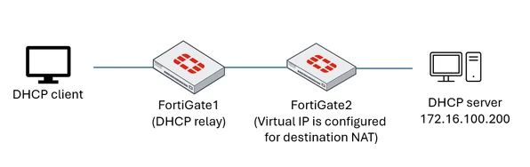

Sample of affected topology:
The DHCP relay is configured on FortiGate1 under the interface settings. The relay IP address is not the real IP address of the DHCP server, but it is a NATed IP address, 192.168.100.200.
Virtual IP is configured on FortiGate2 to translate the DHCP server IP address 172.16.100.200 to 192.168.100.200.
After upgrading to v7.4.4 or later, the error message 'Error: can't find a matching server in the relay' can be found from DHCP relay debugging.

(xid:06958b1e) Server ip 172.16.100.200 found in packet (xid:06958b1e) Server IP 172.16.100.200, Error: can't find a matching server in the relay
This is the expected behavior in v7.4.4 and later because the known issue ID 854334 has been resolved: Resolved issues.
  • Before v7.4.4, a DHCP request will be sent to all servers even if there is option 54 (DHCP server identifier).
  • After v7.4.4, FortiOS will only send requests to the DHCP server IP in option 54.
The option to send a relay to all DHCP servers is the workaround.
