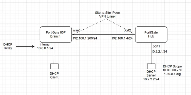

Scenario:
Branch office users want to obtain IP addresses from a central DHCP server located in the Hub over an existing IPsec Site-to-Site VPN tunnel.

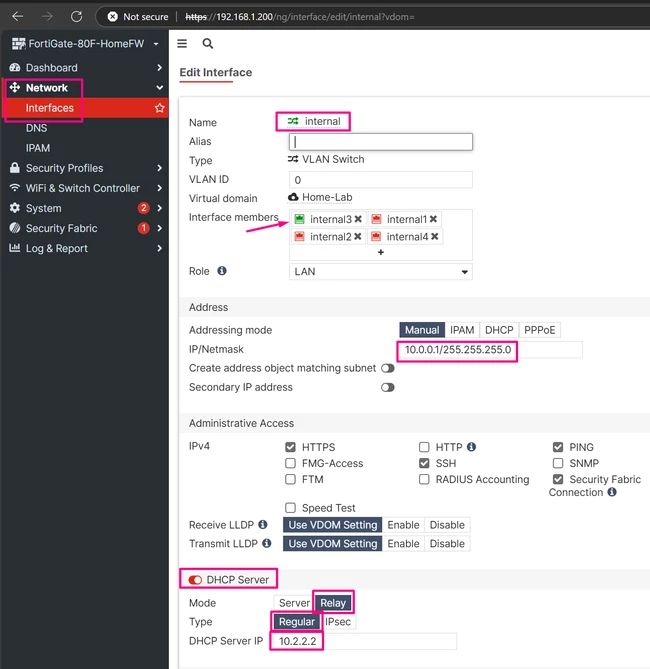

  1. The DHCP client is connected to the 'internal' Hardware Switch (on the FortiGate-80F - branch office firewall). The 'internal' interface on the Branch FortiGate is configured with 10.0.0.1/24 statically. Since the first DHCP DISCOVER broadcast message hits this interface, the DHCP Relay is to be configured here:
config system interface
    edit "internal"
        set vdom "Home-Lab"
        set dhcp-relay-service enable
        set ip 10.0.0.1 255.255.255.0
        set allowaccess ping https ssh fabric
        set type hard-switch
        set stp enable
        set role lan
        set dhcp-relay-ip "10.2.2.2"
Important note:
It is a general notion to use 'set dhcp-relay-type ipsec'. However, it is not used in this scenario. It is used to assign IP addresses to a Remote Access VPN client. Use the default 'set dhcp-relay-type regular' here.
