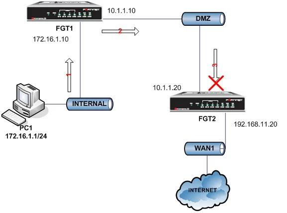

The following diagram illustrates the behavior of RPF :
In the first case, it is assumed that FGT2 does not have a route for 172.16.1.0/24 on the DMZ interface.

When PC1 pings 192.168.11.1, for example, the packets from PC1 are dropped by FGT2.
The packets are seen arriving on FGT2 but never routed out:

In the second case, a route is put back to PC1 (172.16.1.0/24) in the routing table of FGT2:
