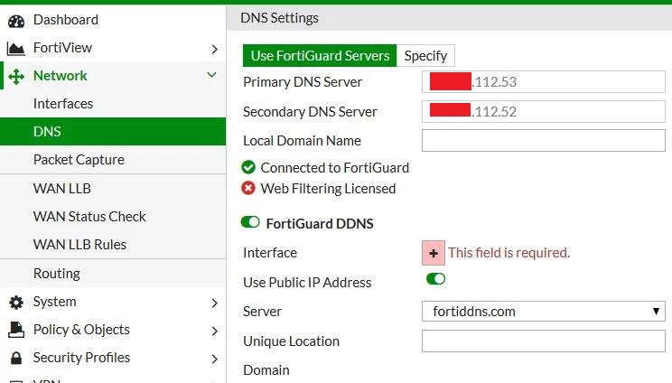

External NAT or public IP addresses can be associated with the DDNS service with the option 'Use Public IP Address' in the GUI or with the command 'use-public-ip' in the CLI.

Notes:
  • A license or subscription is not required to use the DDNS service.
  • On FortiGate VMs and 1000-series or higher, DDNS can only be configured via the CLI.
  • Configuring DDNS via the GUI is not supported when the FortiGate is not using FortiGuard DNS Servers. FortiGate does not support DDNS when in transparent mode.
  • The 'use-public-ip' option is only available when 'ddns-server' is set to 'FortiGuardDDNS'.
  • Ensure traffic port forwarding on the headend router is set to redirect data traffic from the public IP (DDNS FQDN) to the internal IP and port on the FortiGate.

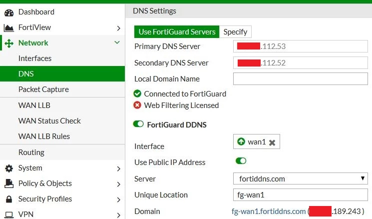

Once bound, the public IP address will be shown in parentheses in the GUI:
And can also be consulted via CLI:
config system ddns
get
ddnsid              : 1
ddns-server         : FortiGuardDDNS
ddns-domain         : fg-wan1.fortiddns.com
use-public-ip       : enable
monitor-interface   : "wan1"
bound-ip            : xxx.xxx.189.243
