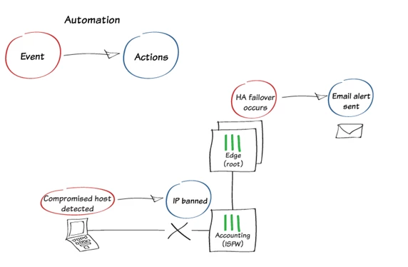

Each automation pairs an event trigger and one or more actions, which allows for monitoring of the network and taking appropriate action when the Security Fabric detects a threat.
Use automation stitches to detect events from any source in the Security Fabric and apply actions to any destination.
In this example, the following automation stitches are created:
  • Ban a compromised host’s IP address.
  • Send an email alert when HA failover occurs.
In this example, the Security Fabric consists of an edge, an HA cluster that is the root FortiGate of the Security Fabric, and three ISFW FortiGates (Accounting, Marketing, and Sales).
Configure the automation stitches on the root FortiGate and the settings are synchronized with the other FortiGates in the Security Fabric.

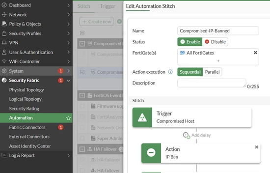

  1. To create a new Automation Stitch that bans the IP address of a compromised host, go to Security Fabric -> Automation and select 'Create New'.
  2. Set FortiGate to 'All FortiGates'.
  3. Set Trigger to 'Compromised Host'.
  4. Set Action to 'IP Ban'.
Example configuration in the CLI:
config system automation-stitch
    edit "Compromised-IP-Banned"
        set trigger "Compromised Host"
        config actions
                set action "IP Ban"
                set delay <0-3600s>           <----- Optional.
                set required enable
Delay can also be configured between the automation-stitch action. Once the automation-stitch is triggered, it will implement the set action after the delay timer. If multiple actions are in place, the set delay per action will be implemented depending on the action sequence.

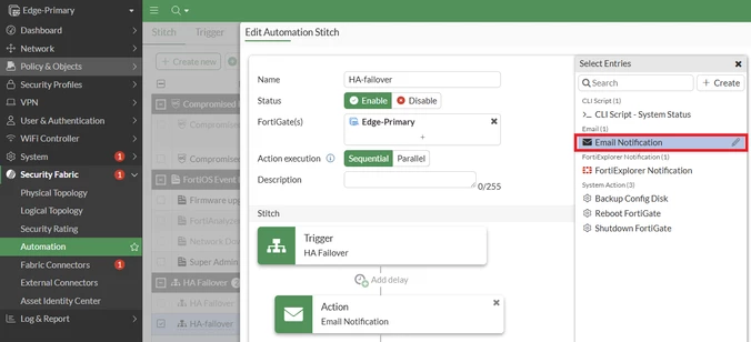

  1. Create a second Automation Stitch that sends an email alert when HA failover occurs.
  2. Set FortiGate to 'Edge-Primary', which is part of the only HA cluster in the Security Fabric.

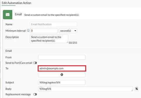

  3. Set Trigger to 'HA Failover'. Under Action, edit 'Email Notification' and specify the email.
Set 'Action' to 'Email Notification', select 'Apply' and select 'OK'.
    edit "HA-failover"
        set trigger "HA Failover"
        config actions
                set action "Email Notification"
                set required enable
        set destination "HA-failover"
