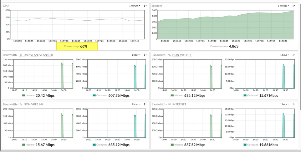

  1. NON-NP VDOM Link.
Network Topology:
FortiTester as Sender -> [User VLAN] VRF 11 - Fortigate 101F [NON-VRF11-0] -> [NON-VRF11-1] VRF 1 - Fortigate 101F [INTERNET] -> FortiTester as Receiver
Firewall Policy:
Generated Enterprise Mixed Traffic:
get sys performance status
CPU states: 31% user 12% system 0% nice 31% idle 0% iowait 0% irq 26% softirq
CPU0 states: 34% user 16% system 0% nice 25% idle 0% iowait 0% irq 25% softirq
CPU1 states: 8% user 2% system 0% nice 66% idle 0% iowait 0% irq 24% softirq
CPU2 states: 27% user 12% system 0% nice 28% idle 0% iowait 0% irq 33% softirq
CPU3 states: 33% user 15% system 0% nice 26% idle 0% iowait 0% irq 26% softirq
CPU4 states: 37% user 14% system 0% nice 24% idle 0% iowait 0% irq 25% softirq
CPU5 states: 35% user 12% system 0% nice 26% idle 0% iowait 0% irq 27% softirq
CPU6 states: 35% user 14% system 0% nice 25% idle 0% iowait 0% irq 26% softirq
CPU7 states: 38% user 11% system 0% nice 25% idle 0% iowait 0% irq 26% softirq
Memory: 3701336k total, 1742416k used (47.1%), 1519624k free (41.1%), 439296k freeable (11.8%)
Average network usage: 653521 / 654282 kbps in 1 minute, 98362 / 98484 kbps in 10 minutes, 96965 / 97087 kbps in 30 minutes
Maximal network usage: 732769 / 733595 kbps in 1 minute, 732769 / 733595 kbps in 10 minutes, 746510 / 747358 kbps in 30 minutes
Average sessions: 3707 sessions in 1 minute, 1190 sessions in 10 minutes, 991 sessions in 30 minutes
Maximal sessions: 4591 sessions in 1 minute, 4592 sessions in 10 minutes, 5820 sessions in 30 minutes
Average session setup rate: 1911 sessions per second in last 1 minute, 293 sessions per second in last 10 minutes, 297 sessions per second in last 30 minutes
Maximal session setup rate: 2143 sessions per second in last 1 minute, 2148 sessions per second in last 10 minutes, 2179 sessions per second in last 30 minutes
Average NPU sessions: 0 sessions in last 1 minute, 0 sessions in last 10 minutes, 0 sessions in last 30 minutes
Maximal NPU sessions: 0 sessions in last 1 minute, 0 sessions in last 10 minutes, 0 sessions in last 30 minutes
Average nTurbo sessions: 0 sessions in last 1 minute, 0 sessions in last 10 minutes, 0 sessions in last 30 minutes
Maximal nTurbo sessions: 0 sessions in last 1 minute, 0 sessions in last 10 minutes, 0 sessions in last 30 minutes
diag sys top 1 30 1
Run Time: 3 days, 5 hours and 9 minutes
29U, 0N, 11S, 35I, 0WA, 0HI, 25SI, 0ST; 3614T, 1481F
ipsengine 403 R < 66.0 1.3 6
ipsengine 404 S < 65.0 1.3 7
ipsengine 400 R < 64.5 1.3 3
ipsengine 401 R < 64.5 1.3 4
ipsengine 399 R < 62.0 1.3 2
ipsengine 402 R < 60.0 1.3 5
ipsengine 398 S < 54.6 1.4 0

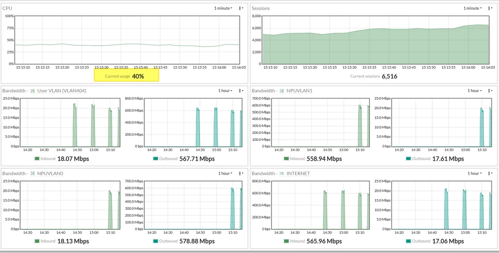

  1. NP VDOM Link.
Network Topology:
FortiTester as Sender -> [User VLAN] VRF 11 - Fortigate 101F [NPUVLAN0] -> [NPUVLAN1] VRF 1 - Fortigate 101F [INTERNET] -> FortiTester as Receiver
(root) # sudo global get sys performance status
CPU states: 24% user 5% system 0% nice 63% idle 0% iowait 0% irq 8% softirq
CPU0 states: 23% user 8% system 0% nice 66% idle 0% iowait 0% irq 3% softirq
CPU1 states: 7% user 0% system 0% nice 62% idle 0% iowait 0% irq 31% softirq
CPU2 states: 26% user 6% system 0% nice 62% idle 0% iowait 0% irq 6% softirq
CPU3 states: 25% user 7% system 0% nice 65% idle 0% iowait 0% irq 3% softirq
CPU4 states: 29% user 5% system 0% nice 63% idle 0% iowait 0% irq 3% softirq
CPU5 states: 27% user 6% system 0% nice 63% idle 0% iowait 0% irq 4% softirq
CPU6 states: 28% user 5% system 0% nice 62% idle 0% iowait 0% irq 5% softirq
CPU7 states: 25% user 6% system 0% nice 64% idle 0% iowait 0% irq 5% softirq
Memory: 3701336k total, 1742640k used (47.1%), 1520552k free (41.1%), 438144k freeable (11.8%)
Average network usage: 591837 / 592563 kbps in 1 minute, 204458 / 204714 kbps in 10 minutes, 154765 / 154955 kbps in 30 minutes
Maximal network usage: 653126 / 653862 kbps in 1 minute, 683497 / 684307 kbps in 10 minutes, 746510 / 747358 kbps in 30 minutes
Average sessions: 5424 sessions in 1 minute, 2624 sessions in 10 minutes, 1988 sessions in 30 minutes
Maximal sessions: 6393 sessions in 1 minute, 7544 sessions in 10 minutes, 7544 sessions in 30 minutes
Average session setup rate: 1737 sessions per second in last 1 minute, 643 sessions per second in last 10 minutes, 471 sessions per second in last 30 minutes
Maximal session setup rate: 2033 sessions per second in last 1 minute, 2189 sessions per second in last 10 minutes, 2189 sessions per second in last 30 minutes
Average NPU sessions: 3142 sessions in last 1 minute, 1313 sessions in last 10 minutes, 437 sessions in last 30 minutes
Maximal NPU sessions: 4064 sessions in last 1 minute, 4064 sessions in last 10 minutes, 4064 sessions in last 30 minutes
Average nTurbo sessions: 1635 sessions in last 1 minute, 669 sessions in last 10 minutes, 223 sessions in last 30 minutes
Maximal nTurbo sessions: 2094 sessions in last 1 minute, 2094 sessions in last 10 minutes, 2094 sessions in last 30 minutes
(root) # diag sys top 1 30 1
Run Time: 3 days, 5 hours and 25 minutes
25U, 0N, 6S, 61I, 0WA, 0HI, 8SI, 0ST; 3614T, 1485F
ipsengine 398 R < 40.8 1.4 0
ipsengine 399 S < 36.9 1.3 2
ipsengine 402 S < 36.9 1.3 5
ipsengine 403 R < 35.4 1.3 6
ipsengine 401 R < 33.9 1.3 4
ipsengine 404 R < 30.5 1.3 7
ipsengine 400 S < 29.0 1.3 3
The CPU utilization improves on the second test. NPU and NTurbo sessions increased. NPU VDOM link interfaces support traffic offloading.
