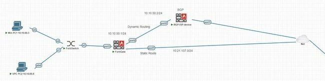

In some network topologies, FortiGate has been set up with more than one default route for redundancy and one of the internet links uses dynamic routing to push the default route while another is connected using the static default links. In cases like these, it becomes challenging to utilize both ISP links.
Note: FortiOS will always prefer a static route of the same prefix length over a dynamic route, even if the AD is the same.
In this example, BGP is already configured and receiving a default route from the neighbor.

Now, SD-WAN rules can be used to steer the traffic for PC1 through BGP ISP and PC2 through the static route ISP:
Results Verification – The packet capture showing traffic coming from 10.10.60.3 (PC1) is going out through Port1 (BGP) and traffic from 10.10.60.6 (PC2) is going via Port2 (Static). (Packets have source NAT applied while leaving, which means a different source IP will be seen when traffic leaves the interface)
