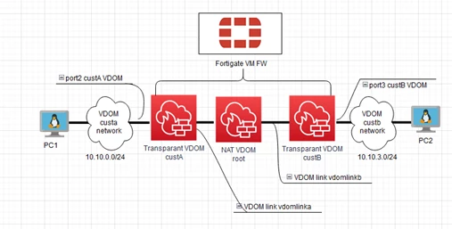

To connect 2 transparent VDOM’s , Inter-VDOM routing is not supported when both VDOMs use transparent mode and the only way to do that is using the NAT VDOM between them with VDOM links on which it is possoble to assign IP addresses.
In the topology for default gateway of PC1 is configured an IP address of vdomlinka, for PC2 default gateway is vdomlinkb.
If there is another L3 device which is acting as a gateway for the clients, it is possible to configure route for the remote network behind the other transparent VDOM, next hop should be the vdomlink.
Example topology:
Here is the step by step guide:
Assume that VDOMs are already created, in this article, the following names are used:
custa – Transparent VDOM
custb – Transparent VDOM
root – NAT VDOM
Port 2 is assigned to custa VDOM, Port3 is assigned to custb VDOM.
Because on the transparent VDOM , it is not possible to assign IP addresses (expect for management purpose ) in order to connect both transparent VDOMs, NAT VDOM will be used with VDOM links with, on the VDOM links, it is possible to assign an IP addresses but only on the VDOM links assigned to NAT VDOM.

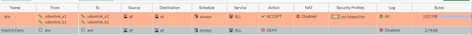

On the root VDOM no special settings are configured only rules which allow communication to / from both vdom links, it is possible to setup a security profiles .

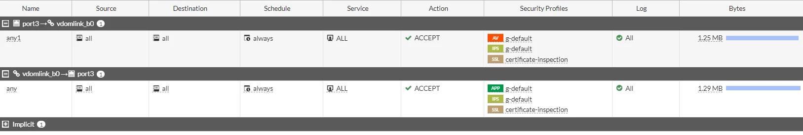

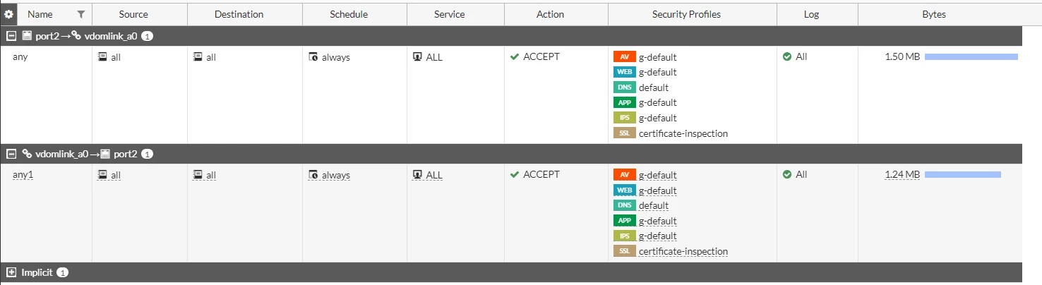

On the transparent VDOMS as per requirements you can configure UTM  features .
FW policies on VDOMs :
custa VDOM:
custb VDOM:
root VDOM:
