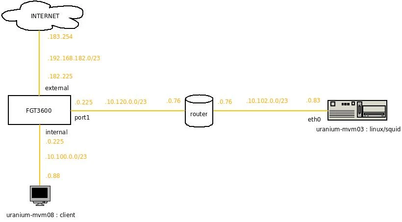

This article describes how to setup WCCP on the FortiGate to intercept and redirect HTTP traffic (TCP port 80) to a Linux squid transparent proxy.
GRE encapsulation is used to tunnel intercepted traffic to the squid. This article covers the Linux and squid configuration.  Key concepts of the architecture are discussed.  Verification and troubleshooting information is provided.
All FortiGates or VDOMs in NAT mode.
Diagram
Note :
  • We intentionally use a router between the FortiGate and the squid even if it is not a requirement. This is a key differentiator between the 2 WCCP encapsulation methods "GRE" and "L2 Forwarding". Unlike "L2 Forwarding", the GRE method allows to cross routers between the FortiGate and the caches.
  • The connection with the cache is using a specific interface in this example as this is the most common practice.

Expectations:
- uranium-mvm08 requests HTTP traffic on the Internet using TCP port 80 (browser is not configured to use a proxy)
- FGT3600 intercepts the traffic with a WCCP policy and redirects traffic to uranium-mvm03 squid transparent proxy through a GRE tunnel
- uranium-mvm03 squid gets the content from the Internet if not already in the cache via FortiGate port1
- uranium-mvm03 squid returns the content towards the FortiGate for uranium-mvm08 using the GRE tunnel
- FGT3600 receives the content from GRE and hooks it back to uranium-mvm08 using the WCCP policy
