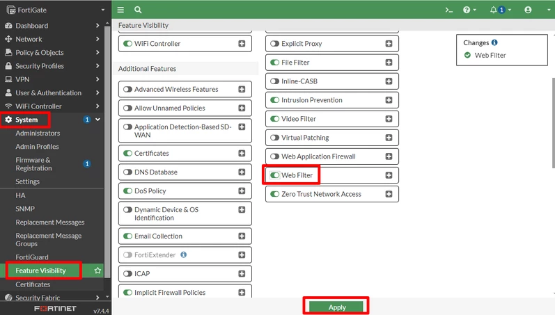

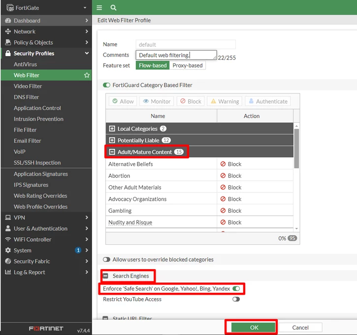

- Enable web filtering: Go to System -> Feature Visibility and make sure that 'Web Filter' is ON. If necessary, apply the changes.

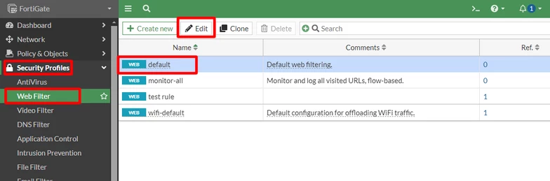

- Block the Adult/Mature Content category and enable Safe Search. Go to Security Profiles -> Web Filter and edit the default profile. Enable FortiGuard Categories. Select the Adult/Mature Content category and set it to 'Block'. Under Search Engines, select 'Enable Safe Search' and 'Search Engine Safe Search – Google, Yahoo!, Bing, Yandex'.

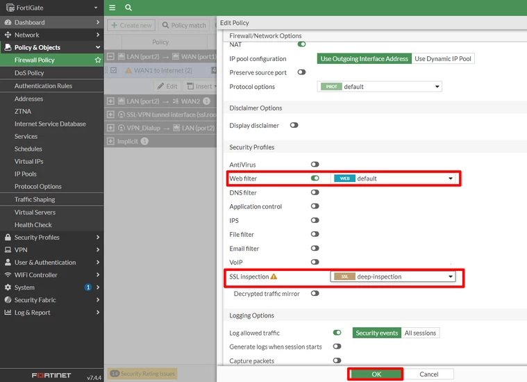

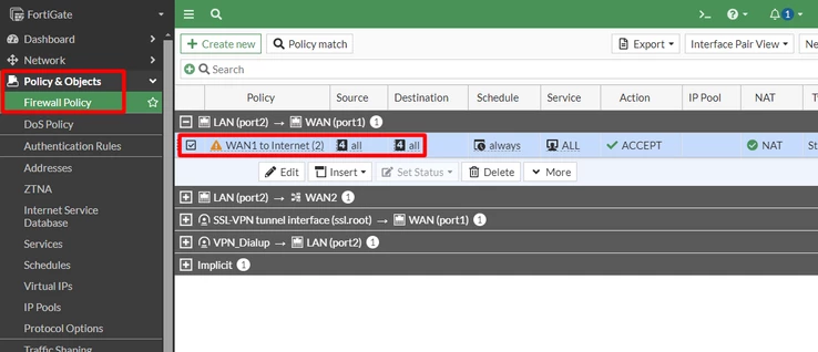

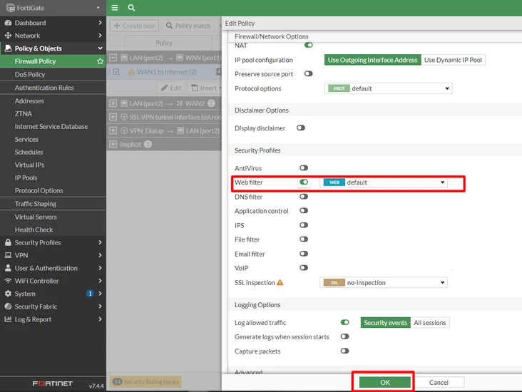

- Add web filtering to the Internet access policy. Go to Policy & Objects -> Policy -> IPv4 and edit the policy that allows connections from the internal network to the Internet. Under 'Security Profiles', enable 'Web Filter' and set it to use the default profile.

Go to Policy & Objects -> Policy -> IPv4 and edit the policy that allows connections from the internal network to the Internet. Set SSL/SSH Inspection to use the deep-inspection profile. Using the deep-inspection profile can cause certificate errors. For information about avoiding this, see Preventing certificate warnings.

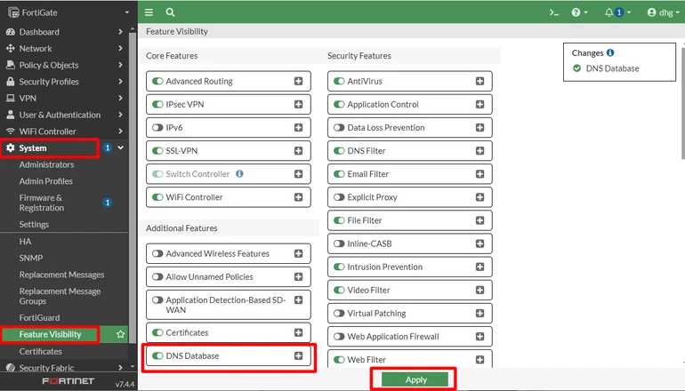

Go to System -> Config -> Features and select 'Show More'. Make sure that the DNS Database is ON. If necessary, apply the changes.

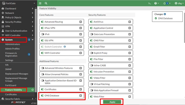

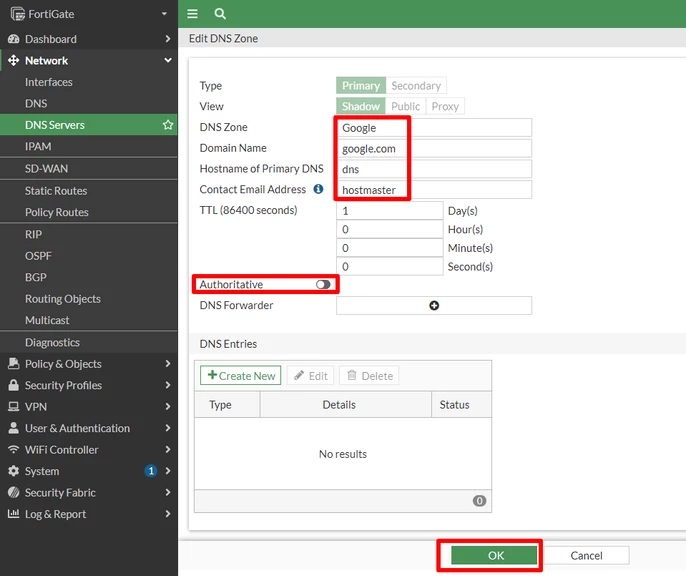

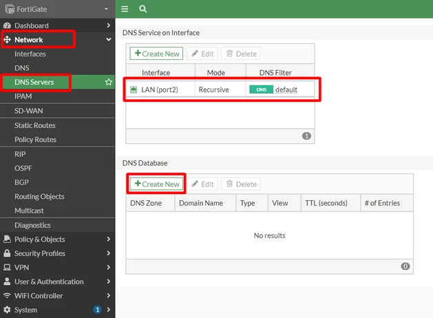

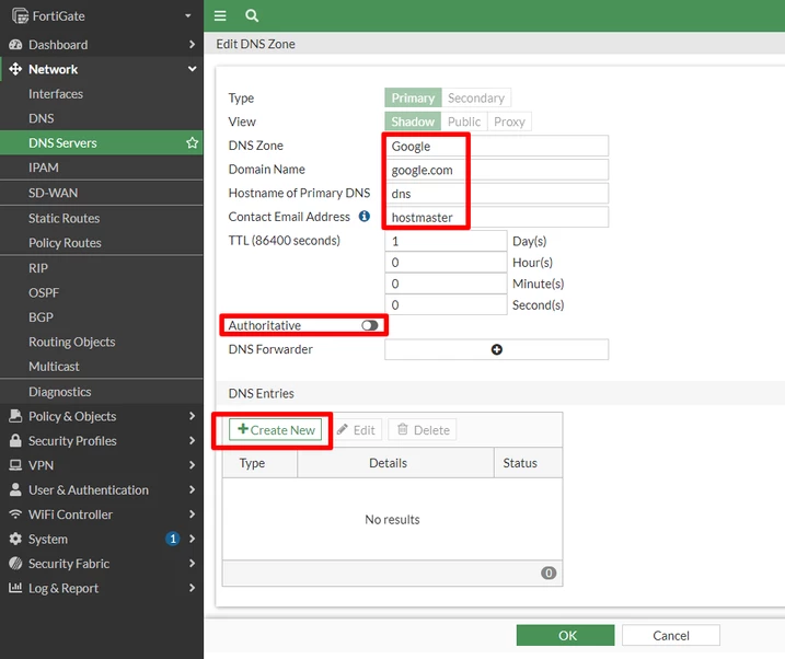

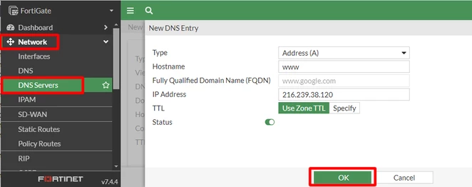

Go to System -> Network -> DNS Servers. The new server is listed under DNS Service on the interface. Under 'DNS Database', select 'Create New'.

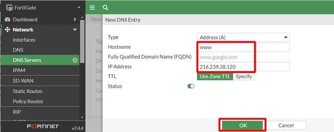

Set the 'DNS Zone' to Google, 'Domain Name' to google.com, and disable Authoritative.

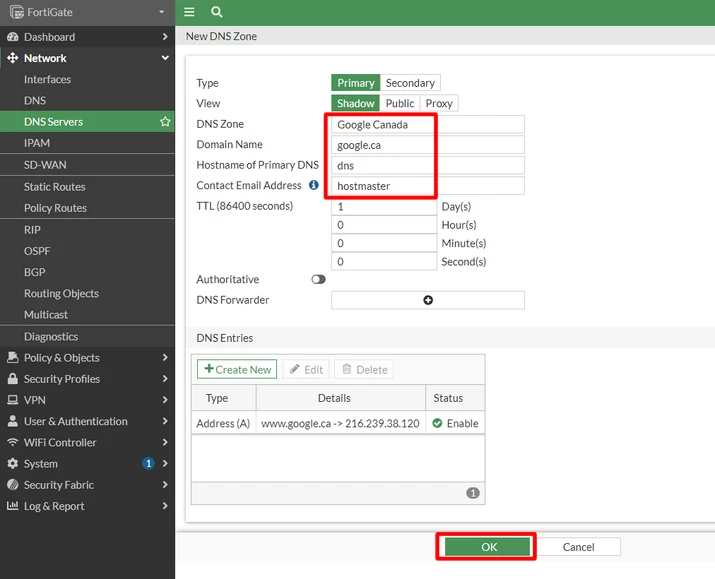

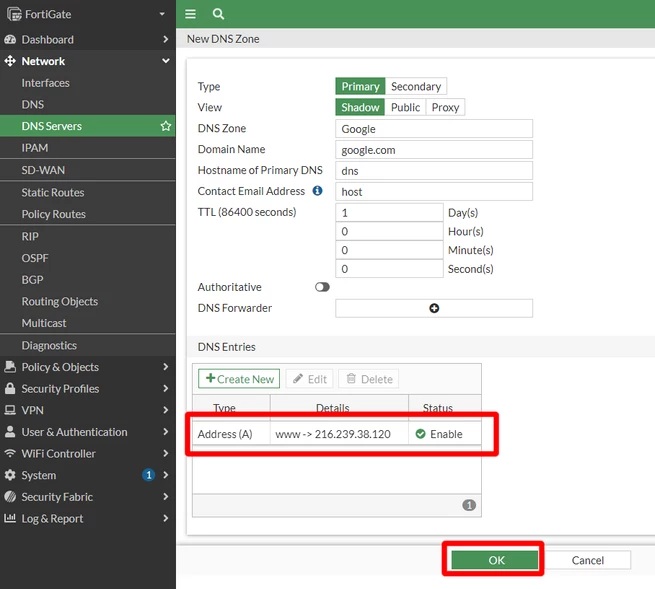

Under 'DNS Entries', select 'Create New'. Set the 'Type' to 'Address (A)', set the 'Hostname' to 'www', and set the 'IP Address' to '216.239.38.120' (the IP address of forcesafesearch.google.com).
If required, create additional DNS Database entries for other Google search domains (an entry for www.google.ca is shown above).

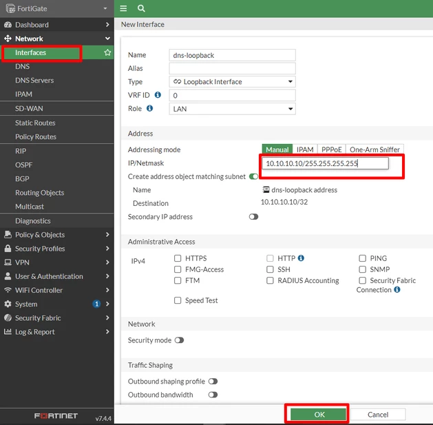

Go to System -> Network -> Interfaces and create an interface to be used for the FortiGate DNS service.
Set the 'Type' to 'Loopback Interface' and assign an IP/Network Mask (in the example, 10.10.10.10/255.255.255.255).

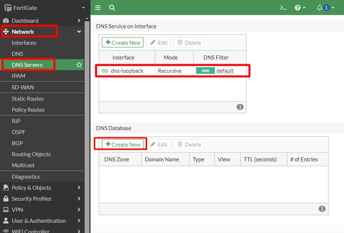

Go to System -> Network -> DNS Servers. The new server is listed under 'DNS Service' on 'Interface'.
Set 'DNS Zone' as 'Google', 'Domain Name' to 'google.com', and disable Authoritative.
Set 'Type' to 'Address (A)', set 'Hostname' to 'www', and 'IP Address' to '216.239.38.120' (the IP address of forcesafesearch.google.com).
If required, create additional DNS Database entries for other Google search domains (an entry for www.google.ca is shown).

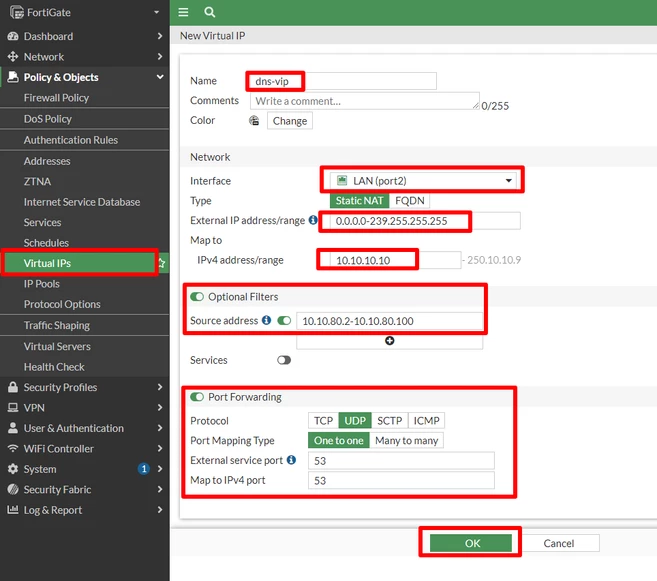

Enter the following command into the CLI Console to create a new virtual IP.
Set 'src-filter' to the IP range of the internal users (in the example, 10.10.80.2-10.10.80.100), 'extintf' to the internal interface, and 'mappedip' to the IP address of the loopback interface. Make sure to use the command 'set arp-reply disable' and 'set type load-balance'.
config firewall vip
edit "dns-vip"
set src-filter "10.10.80.2-10.10.80.100"
set extip 0.0.0.0-239.255.255.255
set extintf port2
set portforward enable
set mappedip "10.10.10.10"
set protocol udp
set extport 53
set mappedport 53

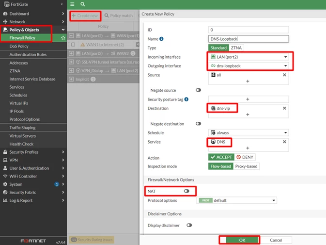

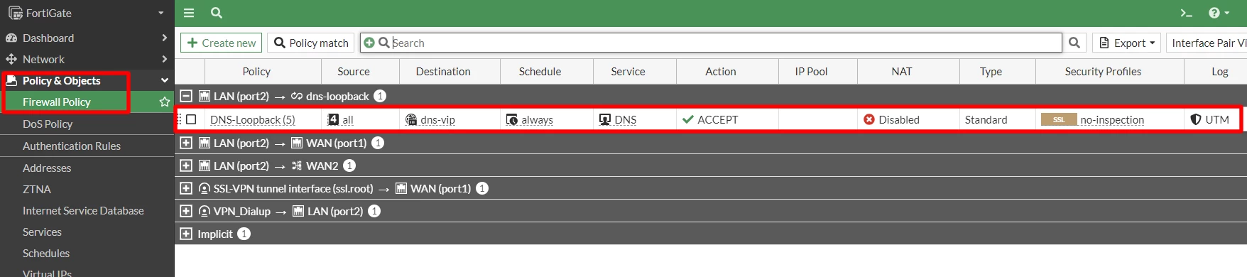

Go to Policy & Objects -> Policy -> IPv4 and create a policy to use the virtual IP to intercept DNS queries.
Set the 'Incoming Interface' to the 'internal interface', the 'Outgoing Interface' to the 'loopback interface', the 'Destination Address' to the 'virtual IP', and the 'Service' to' DNS'. Make sure NAT is disabled.
Select the Global View of the policy list.
Make sure that the new policy is located above the policy that allows connections from the internal network to the internet.
