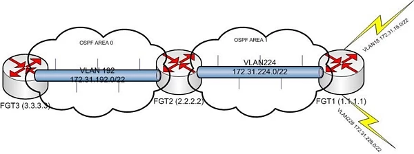

Before route filtering, FGT3 (router-id 3.3.3.3) receives all of the networks announced by 'FGT1' (router-id 1.1.1.1). In this example, route filtering will limit the received routes to 172.31.16.0/22. However, the command distribute-list in cannot be used on FGT3 because it is not a managed unit.
This article will explore configuring the filtering to occur on the Area Border Router (FGT2 (router-id 2.2.2.2)) with the filter-list command in the above example.
FGT1 (router-id 1.1.1.1) is connected to OSPF area 1 through the 'internal' interface.
All connected networks are connected through OSPF.

FGT2 (router-id 2.2.2.2), acting as an ABR, is connected to OSPF area 0 and OSPF area 1.
This router will be configured to filter routes.

FGT3 (router-id 3.3.3.3) is connected to OSPF area 0:

Below is a route-filtering configuration for FGT-2:
config router prefix-list
    edit "FILTER_AREA_1_NETWORKS"
        config rule
                set action deny
                set prefix 172.31.228.0 255.255.252.0
                unset ge
                unset le
        set action deny
        set prefix 172.31.224.0 255.255.252.0
        unset ge
        unset le
        edit 3
        set action permit
        set prefix any
        unset ge
        unset le
Apply the filter-list either under area 1 with the 'out' direction or under area 0 with the 'in' direction.
Area 1:
config router ospf
config area
edit 0.0.0.1
config filter-list
set list "FILTER_AREA_1_NETWORKS"
set direction out          <--- Default direction value.
Or Area 0:
config router ospf
    config area
        edit 0.0.0.0
    config filter-list
set direction in
