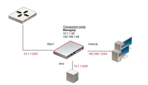

A FortiGate unit running in Transparent mode normally has only one IP address, the management IP. To support NAT in Transparent mode, it is possible to add a second management IP. These two management IPs must be on different subnets. FortiGate interfaces will respond to connections to both of these IP addresses.
In the following example, all of the PCs on the internal network (subnet address 192.168.1.0/24) are configured with 192.168.1.99 as their default route. One of the management IPs of the FortiGate unit is set to 192.168.1.99. This configuration results in a typical Transparent mode firewall. When a user on the internal network attempts to connect to the internet, the default route sends packets destined for the internet to the FortiGate unit's internal interface.
On the DMZ network (subnet address 10.1.1.0/24) all of the PCs have a default route of 10.1.1.99.
This example describes adding an Internal WAN1 firewall policy to relay these packets from the Internal interface to the WAN1 interface to the Internet.
Because the WAN1 interface does not have an IP address of its own, it is necessary to add an IP pool to the WAN1 interface that translates the outgoing packets' source addresses to an IP address on the network connected to the WAN1 interface.
The steps below describe adding an IP pool with a single IP address of 10.1.1.201. So all packets sent by a PC on the internal network that the Internal accepts to WAN1 policy leave the WAN1 interface with their source address translated to 10.1.1.201. These packets can now travel across the Internet to their destination.
Reply packets return to the WAN1 interface because they have a destination address of 10.1.1.201. The internal to WAN1 NAT policy translates the destination address of these return packets to the IP address of the originating PC and sends them out the internal interface to the originating PC.

Adding two management IPs.
First, add two management IPs. The second management IP is the default gateway for the internal network.
config system settings
    set manageip 10.1.1.99/24 192.168.1.99/24
