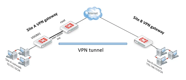

This article describes how to configure IPSec VPN tunnels on Inter-VDOM links to allow VDOMs with no WAN interface to communicate with remote peers through the root VDOM.
FortiGate.
Consider that FortiGate has only one WAN connection assigned to the root VDOM, and an IPSec VPN tunnel should be configured on VDOM1.
Then, the root VDOM should NAT the IKE traffic originating from VDOM1, and send it to the remote peer.
Here is the Step by Step guide:
Site A VPN gateway.
