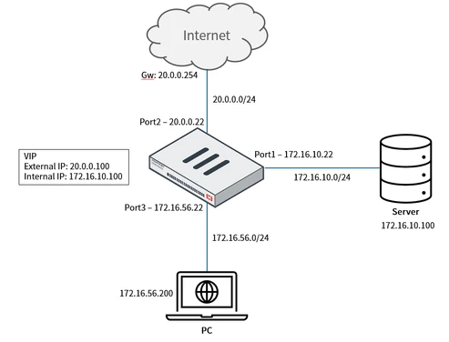

Hair-pinning, also known as NAT loopback, is a technique where a machine accesses another machine on the LAN or DMZ via an external network.
Traffic goes from the LAN to the WAN interface (without actually leaving the network), then is forwarded through a virtual IP to the DMZ.
FortiGate.
If the external IP belongs to FortiGate (IP address of an external interface), FortiGate will require a different set of rules when the external IP is just from range, but not directly configured on FortiGate’s interfaces. In all examples, traffic will be flowing like this: Client -> external IP -> FortiGate -> internal IP -> Server.
Example 1:
Configuration of VIP and two firewall policies. One for external users and the other for internal users.
The following is the configuration for the VIP.  The External Internal Interface 'extintf' can be configured as 'any' or specific.

The external IP address is from the same subnet but does not belong to FortiGate directly. Use VIP2 from the diagram. There are two options to select extintf: any or specific.
Option 1 (extintf set to 'any'):

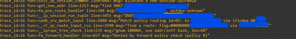

  • If srcintf-filter to VIP2 is configured, the LAN port will need to be a member of that filter. In that case, the same firewall policy as the previous one will be enough. If LAN is not a member of the filter, but only WAN, hairpin will not work even if firewall policies are corrected when the srcintf is WAN directly (next option).
  • In some scenarios, network admin could have configured a policy route sending all traffic to the internet.
config router policy
    edit 65  <-- policy route for the internet traffic LAN to WAN.
        set input-device "lan"
        set src "192.168.1.0"
        set dst "0.0.0.0/0.0.0.0"
        set gateway 20.0.0.254
        set output-device "wan"
This can make after dnat the policy route force the traffic of mapped IP through the WAN interface instead of DMZ, resulting in policy denial.
To fix it, try to configure a new route policy above to stop policy routing the traffic to the mapped IP of the vip.
        set dst "172.16.1.2"  <--- mapped IP of the VIP.
        set action deny <-- To stop policy routing for this traffic.
        set comments "Stop Policy based"

id=65308 trace_id=1 func=print_pkt_detail line=5895 msg="vd-root:0 received a packet(proto=1, 192.168.1.2:33214->172.16.16.10:2048) tun_id=0.0.0.0 from port3. type=8, code=0, id=33214, seq=1."
id=65308 trace_id=1 func=init_ip_session_common line=6076 msg="allocate a new session-0000035b, tun_id=0.0.0.0"
id=65308 trace_id=1 func=iprope_dnat_check line=5331 msg="in-[port3], out-[]"
id=65308 trace_id=1 func=iprope_dnat_tree_check line=823 msg="len=1"
id=65308 trace_id=1 func=__iprope_check_one_dnat_policy line=5191 msg="checking gnum-100000 policy-1"
id=65308 trace_id=1 func=get_new_addr line=1228 msg="find DNAT: IP-10.10.10.2, port-0(fixed port)"
id=65308 trace_id=1 func=__iprope_check_one_dnat_policy line=5286 msg="matched policy-1, act=accept, vip=1, flag=104, sflag=2000000"
id=65308 trace_id=1 func=iprope_dnat_check line=5343 msg="result: skb_flags-02000000, vid-1, ret-matched, act-accept, flag-00000104"
id=65308 trace_id=1 func=fw_pre_route_handler line=178 msg="VIP-10.10.10.2:33214, outdev-unknown"
id=65308 trace_id=1 func=__ip_session_run_tuple line=3515 msg="DNAT 172.16.16.10:8->10.10.10.2:33214"
id=65308 trace_id=1 func=vf_ip_route_input_common line=2605 msg="find a route: flag=04000000 gw-10.10.10.2 via port2"
id=65308 trace_id=1 func=iprope_fwd_check line=789 msg="in-[port3], out-[port2], skb_flags-020000c0, vid-1, app_id: 0, url_cat_id: 0"
id=65308 trace_id=1 func=__iprope_check line=2292 msg="gnum-100004, check-ffffffffa002c2a7"
id=65308 trace_id=1 func=__iprope_check_one_policy line=2044 msg="checked gnum-100004 policy-0, ret-matched, act-accept"
id=65308 trace_id=1 func=__iprope_user_identity_check line=1819 msg="ret-matched"
id=65308 trace_id=1 func=__iprope_check_one_policy line=2262 msg="policy-0 is matched, act-drop"
id=65308 trace_id=1 func=__iprope_check line=2309 msg="gnum-100004 check result: ret-matched, act-drop, flag-08010800, flag2-00004000"
id=65308 trace_id=1 func=iprope_fwd_check line=826 msg="after iprope_captive_check(): is_captive-0, ret-matched, act-drop, idx-0"
id=65308 trace_id=1 func=iprope_fwd_auth_check line=845 msg="after iprope_captive_check(): is_captive-0, ret-matched, act-drop, idx-0"
id=65308 trace_id=1 func=fw_forward_handler line=738 msg="Denied by forward policy check (policy 0)"
Traffic can be observed not leaving the firewall, even though the correct firewall policy is configured from the WAN to the DMZ. After matching with the VIP, the traffic is matched with 'policy 0' instead of the configured firewall policy.

If the external address of the VIP is an IP that is on the same subnet as the FortiGate but does not belong directly to the FortiGate, hairpin NAT can be achieved by specifying the WAN-side interface in the VIP's extintf.
Below is an example configuration to achieve hairpin NAT with two policies: a LAN-to-WAN policy and a WAN-to-DMZ policy:
Configurations:
    config firewall vip
        edit "VIP"
            set extip 20.0.0.100
            set mappedip "172.16.10.100"
            set extintf "port2"
    config firewall policy
            set name "LAN-to-WAN"
            set srcintf "port3"
            set dstintf "port2"
            set srcaddr "all"
            set dstaddr "all"
            set service "ALL"
            set logtraffic all
            set nat enable
            set name "WAN-to-DMZ"
            set srcintf "port2"
            set dstintf "port1"
            set srcaddr "all"
            set dstaddr "VIP"
            set service "ALL"
            set logtraffic all
Flow Trace:

get system session list | grep 20.0.0.100
    PROTO  EXPIRE    SOURCE            SOURCE-NAT   DESTINATION    DESTINATION-NAT
    icmp   55        172.16.56.200:1   -            20.0.0.100:8   172.16.10.100:1
Session List:
session info: proto=1 proto_state=00 duration=7 expire=52 timeout=0 flags=00000000 socktype=0 sockport=0 av_idx=0 use=3
origin-shaper=
reply-shaper=
per_ip_shaper=
class_id=0 ha_id=0 policy_dir=0 tunnel=/ vlan_cos=0/255
state=log may_dirty f00
statistic(bytes/packets/allow_err): org=60/1/1 reply=60/1/1 tuples=2
tx speed(Bps/kbps): 0/0 rx speed(Bps/kbps): 0/0
orgin->sink: org pre->post, reply pre->post dev=9->3/3->9 gwy=0.0.0.0/0.0.0.0
hook=pre dir=org act=dnat 172.16.56.200:1->20.0.0.100:8(172.16.10.100:1)
hook=post dir=reply act=snat 172.16.10.100:1->172.16.56.200:0(20.0.0.100:1)
misc=0 policy_id=2 pol_uuid_idx=15754 auth_info=0 chk_client_info=0 vd=0
serial=003015b5 tos=ff/ff app_list=0 app=0 url_cat=0
rpdb_link_id=00000000 ngfwid=n/a
npu_state=0x000100
no_ofld_reason: npu-flag-off
Traffic Log:
date=2024-08-30 time=16:24:39 eventtime=1725002679069880080 tz="+0900" logid="0000000013" type="traffic" subtype="forward" level="notice" vd="root" srcip=172.16.56.200 identifier=1 srcintf="port3" srcintfrole="undefined" dstip=20.0.0.100 dstintf="port1" dstintfrole="undefined" srccountry="Reserved" dstcountry="United Kingdom" sessionid=3151285 proto=1 action="accept" policyid=2 policytype="policy" poluuid="b062f842-5ecb-51ef-18a3-3977b8166540" policyname="WAN-to-DMZ" service="PING" trandisp="dnat" tranip=172.16.10.100 tranport=0 duration=61 sentbyte=60 rcvdbyte=60 sentpkt=1 rcvdpkt=1 appcat="unscanned"
It can be seen that the traffic goes through two policies but in one session. Hairpin NAT is realized, and traffic passing through the LAN-to-WAN policy is not forwarded from the WAN interface to the Internet, but instead, the process is transferred to the WAN-to-DMZ policy, where it is DestNATed and forwarded directly to the DMZ interface.
