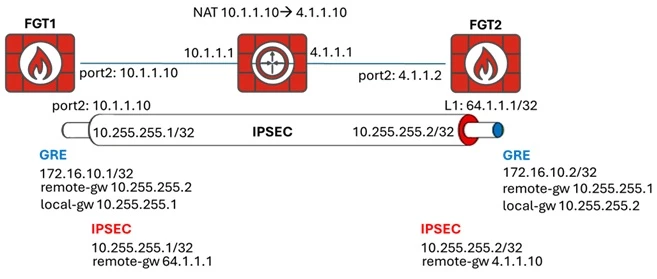

Description This article describes GRE over IPsec configuration between two FortiGate firewalls where one FortiGate is behind a NAT device, and the remote is terminating IPsec on the Loopback interface.
This scenario depicts GRE over IPsec between two FortiGate devices, where one of the peers has private IP address configured on the internet facing interface and is behind a device performing NAT, and IPsec is terminated on the Loopback interface on the remote peer.
The topology is shown in the diagram below. FGT1 is the FortiGate device configured with a private address on the WAN facing port (port2) and is behind the NAT device. FGT2 has a routable IP address configured on the WAN facing and the Loopback1 interfaces.
Topology:
Notes:
  • The WAN facing port on the FortiGate FGT1 is configured with a private IP Address of 10.1.1.10. This IP address is translated to 4.1.1.10 on the NAT device.
  • On the remote FortiGate, Loopback1 is configured with the IP address of 64.1.1.1/32. This IP address will be used to terminate IPsec tunnel on this device.
  • Static routes are configured on both FortiGate firewalls to enable IP connectivity between the IPsec endpoints, and route traffic through the GRE tunnel
