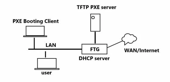

Ensure the following configuration and infrastructure are in place before configuring FortiGate.
  1. TFTP PXE server hosting the installation file (know the file name).
  2. PXE-capable/enabled NIC (Network Interface Card) on the client (PXE Booting Client), and that broadcast originating from the PXE Booting Client can reach the FortiGate, which is acting as a DHCP server in this scenario:
Ensure that there is IP reachability between FortiGate and the TFTP PXE server (the PXE server can be on the same subnet or a different subnet than the PXE client).

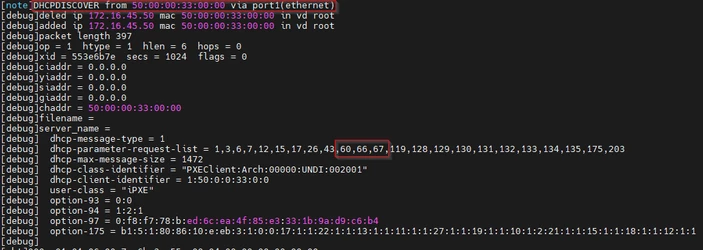

On FortiGate's SSH, use 'diagnose debug application dhcps -1' to collect more details about the DHCP transaction.

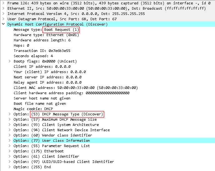

Look for the DHCPDISCOVER coming from the client, and let's make sure the client is requesting the DHCP options necessary for each implementation. Usually, options 60, 66, and 67 are pretty common.
Make sure the FortiGate is sending out a DHCPOFFER.
Use the packet sniffer to collect the DHCP transaction and open it on Wireshark.
filter on ports 67 and 68 UDP.
The DHCPDISCOVERY should look like this, and make sure it includes option 53: Technical Tip: Bootp relay.

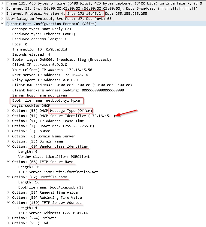

The DHCPOFFER coming from the FortiGate should look like this:
Make sure:
  • The DHCP Server Identifier is the FortiGate IP.
  • It contains the Boot file name.
  • It contains option 53.
  • It contains the desired options like 60, 66, 67, or 150 ( It has been added for illustration purposes).
If the option is not visible in the DHCPOFFER, double-check if the client has included it in the DHCDISCOVERY.

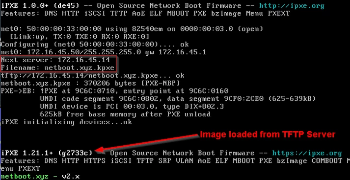

The PXE Client would also provide a nice indication that the DHCP options were received and processed correctly.
