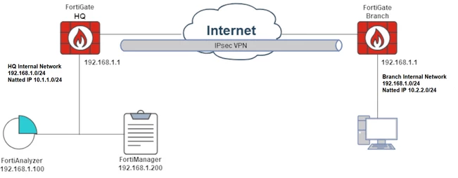

This article assumes the NATing between networks is correct and that there is connectivity between the overlapping subnets.
See the documentation to configure a site-to-site VPN with overlapping subnets.
Due to this traffic being local out traffic, the SNAT or DNAT rules in the firewall policies do not apply to this scenario. There is no way to directly apply NAT to local outbound traffic.

When configuring the Fabric Connectors, the corresponding natted IP address, from the Branch FortiGate's perspective, must be used for the FortiAnalyzer and the FortiManager, in this case, 10.1.1.100 and 10.1.1.200, respectively.

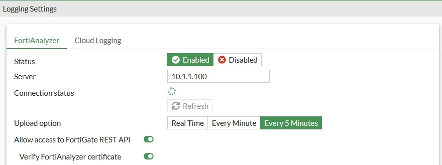

To configure FortiAnalyzer in the GUI, Security Fabric -> Fabric Connectors -> Logging & Analytics, under the Logging Settings, select FortiAnalyzer and enter the server IP.
CLI configuration:
config log fortianalyzer setting
    set status enable
    set server "10.1.1.100"

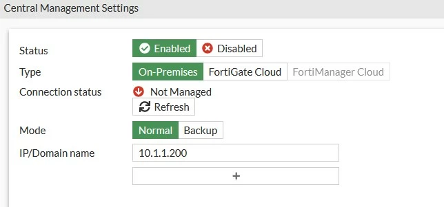

To configure FortiManager in the GUI, Security Fabric -> Fabric Connectors -> Central Management, under the Central Management Settings, select Type as On-Premises and configure the IP/domain name with the IP address.
CLI configuration:
    set type fortimanager
    set fmg "10.1.1.200"

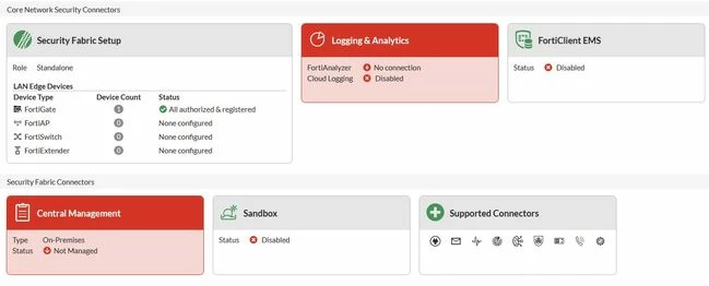

The Fabric connectors are still down. This is due to the FortiGate trying to communicate with FortiAnalyzer or FortiManager with an IP address not allowed by phase2 for the VPN, or not using the correct natted IP address.

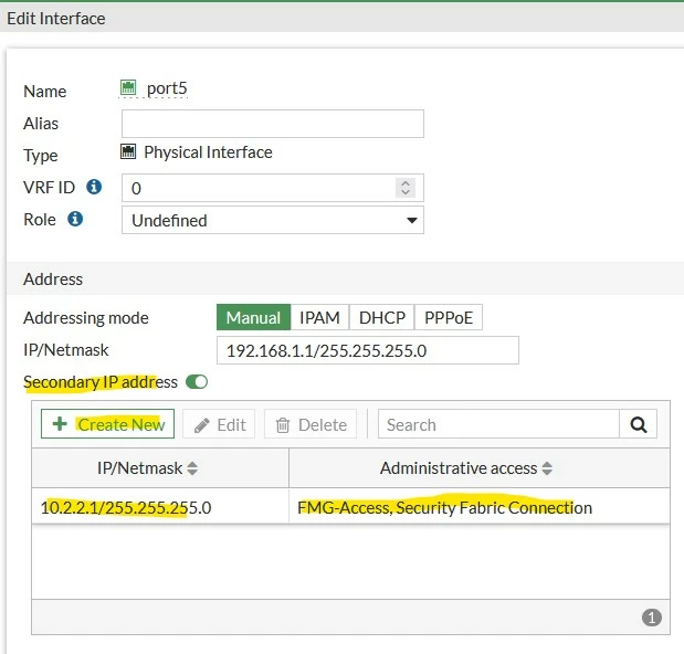

The solution is to configure a secondary IP address matching the Branch’s natted network on the LAN interface and configure the source IP address on each connector.
To set the secondary IP address, Network -> Interfaces, select the interface, enable Secondary IP Address, and select Create New. In this case, the IP address will be 10.2.2.1/24. Administrative Access for FMG-Access and Security Fabric Connection must be enabled on this secondary IP address.
CLI configuration:
config system interface
    edit "port5"
        set ip 192.168.1.1 255.255.255.0
        set allowaccess ping
            config secondaryip
                    set ip 10.2.2.1 255.255.255.0
                    set allowaccess fgfm fabric

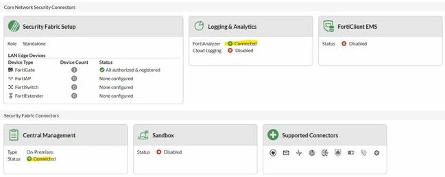

In both cases, FortiGate will have to be authorized by FortiAnalyzer and FortiManager.
After setting the source-ip in both configurations, the Fabric connectors will be able to reach each device.

The Fabric Connectors will now show as 'Connected'.
