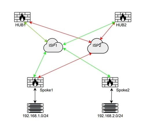

Topology Overview:

Before implementing the route filter, the single-ISP spoke (Spoke2) receives and installs all four paths for the network '192.168.1.0/24'. This includes two paths with next-hop IPs via ISP1 ('10.10.10.1', '10.20.10.1') and two paths with next-hop IPs via ISP2 ('10.10.20.1', '10.20.20.1'). The routing table shows recursive lookups for the ISP2 next-hop IPs via a physical interface (port10), which is incorrect.
