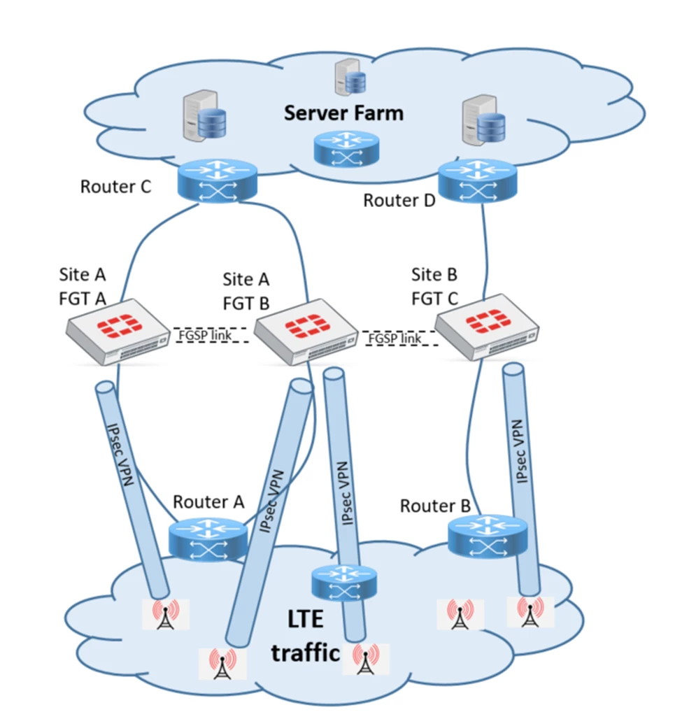

This article describes configuration and verification steps to maintain an FGSP high availability cluster of SecureGateways.
FortiGate v7.2.3 GA.
Important Notes:
  • In the diagram, FGT_A and FGT_B are geographically located at Site A, while FGT_C is at Site B.
  • Layer 3 connectivity between FGT_A, FGT_B, and FGT_C exists to synchronize IPSec SA and its associated session information
  • IPsec clients, typically the LTE endpoints, form an IPsec Tunnel with FGT_A, B, and C through the intermediary routers.
  • Routers perform the task of load sharing the IPsec tunnels between different FGSP members.
  • Traffic can be steered to the appropriate FortiGate without loss through the use of BGP Path attributes and features such as Local Preference, Conditional advertisements, Route maps, AS Path prepend, and other metrics in conjunction with BFD (This article will not explore this fine-tuning).
  • If one of the FortiGates fails, Dynamic Routing and BFD will converge to find the next most suitable FGSP peer with minimum time delay.
  • The configuration on the FortiGate needs to be consistent across all FGSP members to ensure a seamless failover with no disconnection of existing sessions.
  • Note that the IPsec tunnel configuration, firewall policy, and addresses can be synchronized between one FGSP peer and another by configuring Using standalone configuration synchronization if L2 reachability is established.
  • If L2 reachability is not present, the administrator must manually synchronize the configuration between the cluster members.
