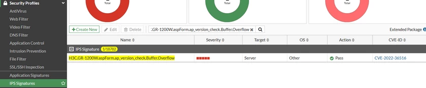

The Signatures related to OT (Operation Technology) will be updated in both Application Control and Intrusion Prevention Profiles. To view the Signature database in the Application Control profile, refer to the above document.
In the IPS Profile, the Signatures related to Operation Technology can be searched:

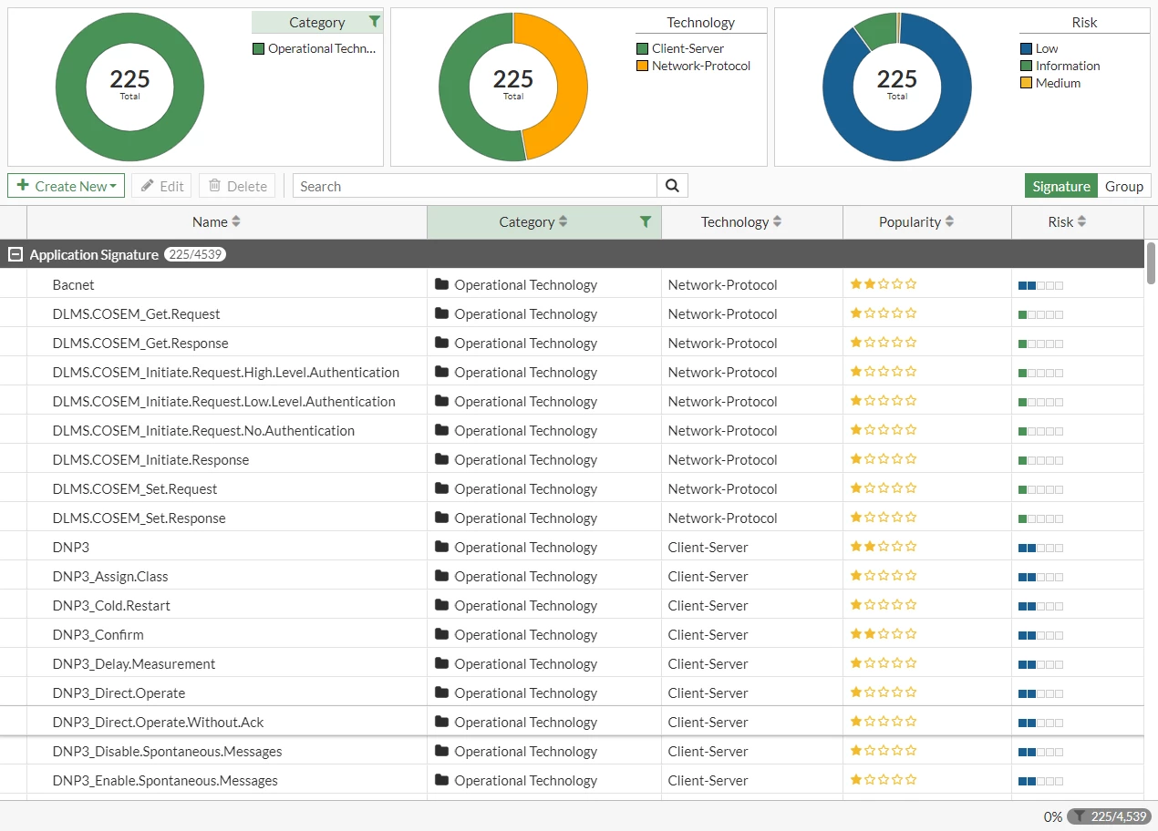

In the Security Profiles -> Application Signaturesfilter the category by Operation Technology to view the OT application signatures.
